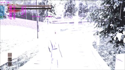

DgVoodoo works really great to upscale the resolution in Deadly Premonition Directors Cut. However when you turn on antialiasing the image becomes way too bright. Any way to fix this?
This is the GOG version btw.
Edit: dgVoodoo 2.62.1

It's not gamma.
The rendering process of this game is very sensitive to resolution scaling and MSAA.
Check out the newest version (2.62.2) that I've just released.
I slightly changed some calcs in the resolution scaling and the game seems to work fine with that (but I'm not sure if all across the game).
Don't force MSAA though, won't work properly.
