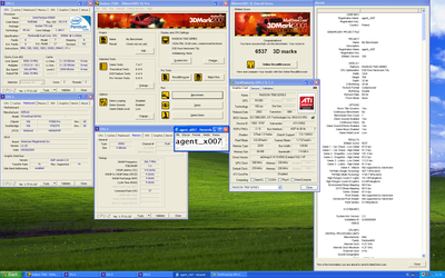

Reply 17 of 24, by agent_x007
eyrOyfj.png^AGP 8x with OC'ed Pentium DC E5800 (unless GPU doesn't support 8x).
Here's my ~6,5k Radeon 7500 score :
1.17 MiB
1270 views
4600 Ti and ~15k result :
1.18 MiB
1268 views
