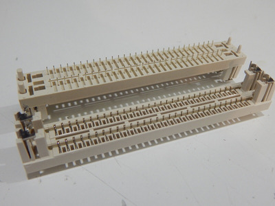

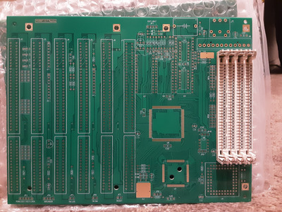

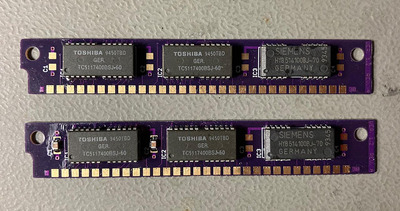

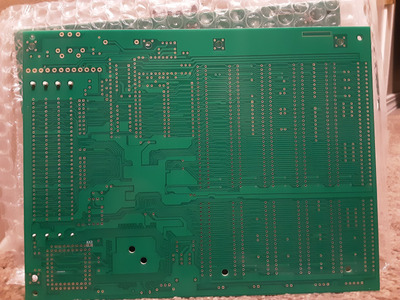

Greetings,
Anyone interested in building their own M396F from https://github.com/Marco-Both/M396F-Replika I have 10 PCB's. One for myself and then 9 others, with parts. I want to build one fully and test before I send out in the wild, but if you all can't wait, I can send out now with parts. I'm waiting on SIMM sockets at the moment. Give me a couple weeks. PCB's I'm selling at cost to break even but no profit. With parts, it will increase the kit quite a lot. Depending on if you want to find them all yourself or rely on what I have on hand. I may work on packaging up some kits. I'd like to stick in the US. Just thought it'd be awesome to at least have the PCB's available. Letting the community know I have some qty available.
Attaching the available PCB's as I test a fit of some dual rank SIMM sockets.
- William
You feel a whole lot more like you do now than you did when you used to.
Reply 24 of 38, by stamasd
Interesting project. I may be interested in one of the PCBs, plus some components. I already have some appropriate stuff - CPUs (386SX, 486SLC etc), 30-pin SIMM sockets (also dual rank), EPROMs, chip sockets etc.
My SIMM sockets are in fact better than the ones pictured above, they have metal clips. 😀

Reply 25 of 38, by Berzerkula
stamasd wrote on 2023-03-23, 22:15:
Hello ,
Metal clips, just couldn't tell from the angle.
-William

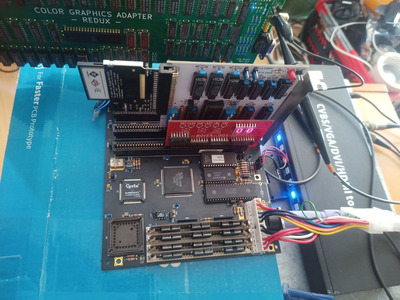

Reply 28 of 38, by Madao
a black beauty with 486SLC2 CPU.
216.63 KiB
1146 views
overall-performance of SLC2-50 is lower than SLC-40 (only CPU power is higher )
Reply 29 of 38, by Nelson68k
Madao wrote on 2023-06-04, 15:55:
Interesting. How did you measure?
Reply 30 of 38, by Madao
here.
Now, i have tweaked board with 486SLC2-50, a bit better performance.
It is not great jump from SLC33 to SLC2-50. I believe: Jump to SLC-40 is better.
