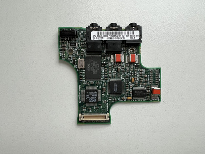

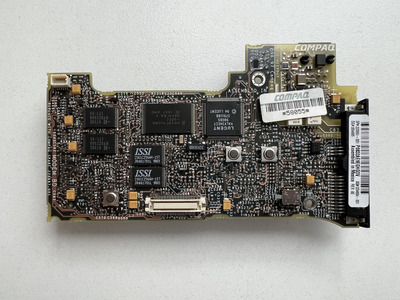

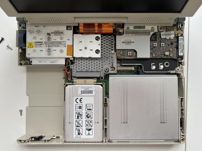

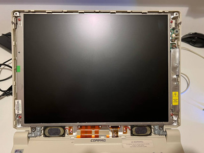

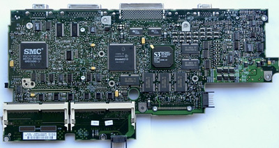

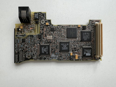

Since I’ve got Toshiba that died from leaked battery, I decided to remove it from Compaq. It was never opened before plus some “clever” person decided to place battery under the screen. Had to remove warranty sticker (I is placed on palmrest so now it looks ugly) and take out the screen. Took some pictures of internals (mb is not mine, didn’t go that deep)
