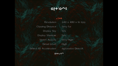

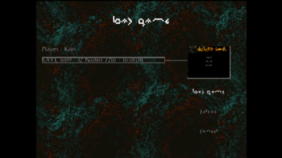

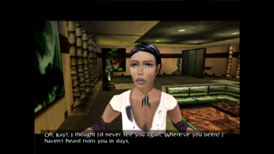

Pixelation in Omikron is still there with WIP69
75.53 KiB
1577 views
379.7 KiB
1577 views

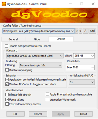

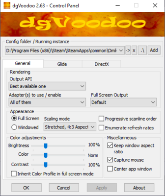

Steam version, these settings. Bug occurs only when subtitles or game UI shows on screen.

I've just checked out the GOG version, and indeed, there is pixelation.
The original game rendering is modified by patch.dll, and the technique used conflicts with dgVoodoo's resolution scaling process.
But luckily, a little patch helps:
http://dege.fw.hu/temp/OmikronNomadSoul_patch.zip
I assume the Steam version has the same version of patch.dll, so this patch can be used together with that too.

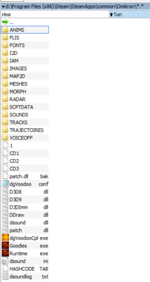

Unfortunately, this patch does not help Steam version. But i can send you some dll/exe files from steam version if this helps 😎

Does the steam version has patch.dll? If it doesn't then I could only debug the game itself to find out what to modify. 🙁
Yes, it has.
