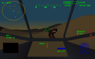

Reply 25 of 45, by IonMage
Sorry for double post, dont see an edit buton.
I installed the patch, no go. I dont mean to deny you of your mercenaries fun, but can you get the 1.05 and 1.06 patches (you need the 1.05 patch installed to install the 1.06 patch, apparently) and see if it stops working for you? Might not be good if the only version that runs is the buggy version, which not everyone has.

Reply 27 of 45, by DosFreak
I've been using v1.0, didn't bother with the patches before.
I applied 1.05 last night and the mission loaded right up and the instructor voice activated. (I also checked the filesizes and they matched yours once I apllied the patch..just in case the patch wasn't being applied).
Also patched to 1.06 and that works fine too.

Reply 30 of 45, by IonMage
MW2.EXE - fatal error #53: SYSERROR_CDNOTFOUND: CD-ROM not mounted
Thats the error I get when I go into a mission.
Does your CD come with the windows version as a second install option? Mine does. Maybe something different in those versions thats doing it?
MW2shell.exe also loads? I never noticed... but then thats because it loaded, heh.
Reply 31 of 45, by DosFreak
Yeah, I've got the very first version of Mercs.
It installs both versions (DOS\WINDOWS) no matter which installation option you choose.
That's the error message I get when I use Mount instead of IMGmount or if I use IMGMount with an image file that doesn't have the audio tracks (or it cannot find the audio tracks because the .cue file is wrong).
