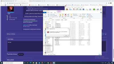

Was nearly there but then got this
Maybe it needs something else under Win10. Did you try ATF Gold and FA?
