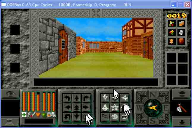

Hello,
Legends of Valour runs fine under DOSBox 0.61 and 0.62, but shows one minor problem on both versions. When you click on certain specific buttons on the 9-button control keypads at the bottom of the screen during play, a copy of the mouse pointer is left permanently on the background image. Not all of the buttons reproduce the problem, just a couple of them.
Repeated clicking on these buttons causes repeated copies of the mouse pointer to overwrite previous ones on the screen.
I've never played the game under real DOS so I don't know if the problem is a DOSBox issue, or a problem with the game itself.

Further to the above message, I have also replicated the issue in DOSBox 0.63 and also on multiple computers. I attach an image of showing the mouse pointers remaining on the screen over certain buttons. I'd be interested to see if anyone else has reproduced this problem or otherwise,
Thanks, benkid77

Reply 4 of 6, by wd
Rank DOSBox Author
DOSBox Author
Looks like reset mouse (int33/ax=0) needs to hide the
mousecurser, qbix might tell you more (at least it works
correctly then).
Btw. position mouse (ax=4) should respect the min_x/min_y, too,
as seen in the game.
