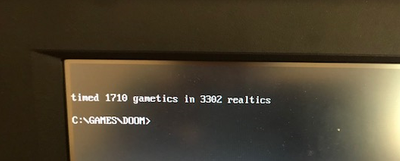

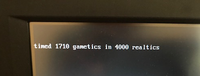

Did some testing with IBM card in DOOM. There is a change in game speed. The CPU is 486 DX-50.
The game runs at 18 FPS with no sound.
86.91 KiB
1883 views
GPL-2.0-or-later
And at about 15 FPS with sound via IBM card.
