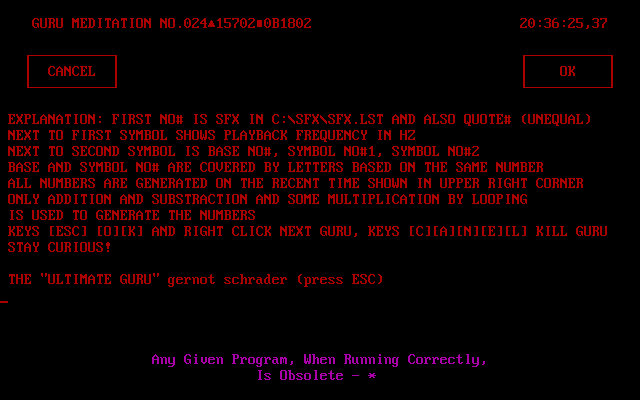

Sometimes - no often a hack is needed, i.e. "nset" is quite good, small and easy to understand but it had a extreme drawback, to many predefined separators and the option to set own seperators didn't restricts the most annoying seperator "space", so it was at hand to change this to no separator except "; and CR" or defined ones (impossible! but some use tables for something else as bookkeeping). The lack of "pipe" is 8a hemlock but can be substituted with redirection most of the time even if i have to use temp file over temp file just to extract a little data. Another small helper "qecho" i use quite often because it echoes without to send a CR LF if you don't specify this, this allows to build fields in tables with the qecho command. qecho can even echo the content of a file and you can overwrite a file on a given column with i.e. the content of a variable. together with "count" by the same developer you can do already quite neat things with this trio and a choice replacement which supports mouse inputs. A bit annoying is that "Horst Schaeffer" who created this small coms seems to be in love with the "bell" which is hmm..... i hate that sound, it hurts my ears. It would be OK if you could say bell or no bell, but don't set such as default, another hack was needed to get rid of "bell" for some of his batch helpers.
This dude even offered a script to compile with the debug program of DOS, and what shall i say? it works, DOSBox quitted but the produced .com works fine.
What surprises me also is that they are such small, if i compare them to other similar programs
Just because of it and for no special reason except to boast a little 😀
One can see well why i love "random" things, "push a button" and it is no surprise that the quote is the proper one, i didn't selected it it just popped up, it could be any of almost 100 quotes but it is exactly the fitting one. As an additional info, the quotes was collected by someone many many years ago who made a proggie called simply "quote" for the amiga to use in the startup sequence. It's a fine collection of quotes and about 50% are computer related, most of them are utters from the very very past of computing but they are still true. Random isn't the proper term here it's rather a sort of generation based on time. Intentionally i setup the table of quotes for the "commander keen wrapper" that's why they are limited in length and i couldn't use all) And all this i reached wit something simple like adding and subtracting. The purpose of this "guru" is simply to display a help for a batch proggie if you entered no or a wrong argument, mostly for myself because i can easy forget the proper use if i have a complex batch with a lot of possible arguments like "randabc" (generates a random name from a property and a nomen like "rusty dagger" (another took over from "phoenix", intentionally "ship name" based on reg.#), generates a random word from a table of syllables like "ogiwuku", generates a random phrase from random words and finally either outputs it to text, a raw audio file of the letters from hand-knitted sfx and optionally plays it back or reconstructs it and optionally plays it back by recall or simply plays back the generated raw audio file) which you will see when i completed this bloody thing. While for all this i made use of a rand program because this would exceed the possibilities of a simple number extraction from time, here i need exact bounds and not like for the guru that i fit the tables to the possible number ranges (using only addition and subtraction, a "strings" program with multiplication/division will allow me to better tune the output, i'm already proud that i could bound an output of 0-99 to 200 or 20, it fails sometimes but that's no surprise and belongs to it).
