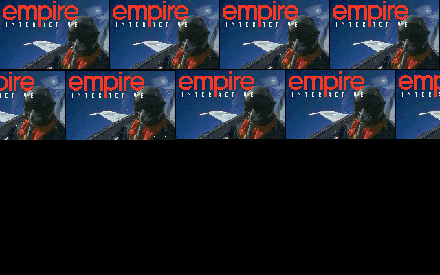

Reply 8 of 10, by Silvio
My OS is Windows XP Home Edition, not DOS. 😦
I've tried to run svgatest.exe in DOSBox 0.63 and I cannot foce my Geforge to work, and I've tried to force in a DOS window of XP.
In this case I can force the game to adapt itself to my gfx card (it saves a set of files that I think contains instructions for gfx), but if I try to start it in a DOS window of XP it crash to descktop, and if I try to run in DOSBox after the recon executed in DOS window of XP, the game shows multiple similar screens then crashes (look attachment). 😵
But I've tried to run in VGA as suggested by robertmo, and it does WORKS! 😁
Many thanks, robertmo!
In some way, i can run again the game; I can stop my ascetic life now..... 😁
