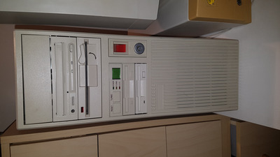

Reply 22 of 40, by keenmaster486
Wow, that's a nice build. I have that same exact case, but it houses a generic 286 machine.
Have you run into any problems with the ET4000? I have one of those and it is not the most compatible card. Does it match well speed-wise with the DX4?
World's foremost 486 enjoyer.
Reply 23 of 40, by firage
Cool. I've only seen the case once aside from mine. It was listed on a local auction site here.
It's a very fast VLB card, so perfect for the CPU. Haven't had many compatibility issues...
The first issue I've ran into is with Crystal Caves - just no luck whatsoever getting a picture. Keen games work fine in SVGA compatibility mode using a CRT; my modern-ish LCD isn't compatible with their output mode, though.
I am always interested to check these bugs and issues out when people point to specific things.
My big-red-switch 486
Reply 24 of 40, by keenmaster486
firage wrote on 2020-03-30, 18:39:
Hmmmmmm interesting! The worst compatibility problems I had were with Commander Keen. Jerky motion all around, and neither the "Fix Jerky Motion" or "SVGA Compatibility" settings did anything to fix it. It was hooked up to a generic Dell CRT.
It is not a VLB card though. It's the 16-bit ISA version of the ET4000, and I had it in my PC/AT, not a 486, so maybe that makes a difference.

Reply 27 of 40, by firage
It is working with write-back L1 enabled.
Issues with WB L1 are specifically to do with bus-mastering controllers, I believe. Such VLB controllers are more likely to be SCSI.

Reply 31 of 40, by K1n9_Duk3
Just out of curiosity, would you mind testing the executable I posted here and see if that makes any difference?
Reply 32 of 40, by firage
I tried it just now and it has no effect, unfortunately. 🙁
Thanks for the effort to fix these games, it's appreciated.
It's the same whether the game's just loaded or jumping around in the game itself, flipping the alternate video mode on and off. Just a black screen and some vertical lines and stripes.
Apogee's Secret Agent, which uses the same graphics engine, has the same display problem as Crystal Caves.
I've now tested a bunch of these games encountering no further issues: Bio Menace, Dangerous Dave 1-2, Catacomb Abyss 3-D, Vinyl Goddess from Mars, Jill of the Jungle, Cosmo's Cosmic Adventure, Duke Nukem 1-2, etc. Dangerous Dave 2 has the same SVGA glitch as Keen, and in its case the compatibility mode is enabled with the "/COMP" command line parameter.
Reply 33 of 40, by firage
Great news on this front - K1n9_Duk3 has successfully developed a fix that works for Crystal Caves and Secret Agent! I've been playing all three episodes of both games using the ET4000/W32p today and it all looks fantastic. 😀

Reply 36 of 40, by Baoran
I really like that type of red switch too and that is why I just couple months ago moved my 486 33Mhz system to a case that has a similar switch. My system is similar to your in some other ways too, it has a VLB ET4000/W32P 2Mb video card and is also connected to roland MT-32. It is definitely my favourite retro system and the big red switch case is perfect for it.
