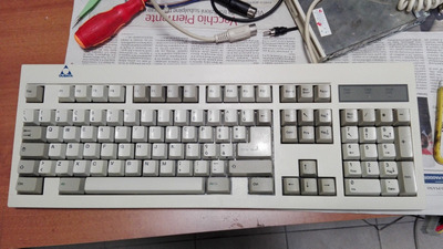

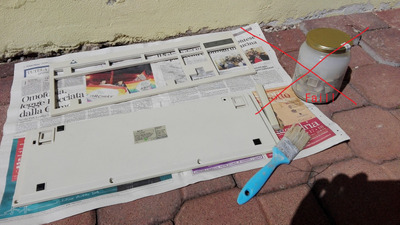

First keyboard, NTC branded Pc keyboard. Tried to make a little experiment here:
Poured some cream into a jar of water, and tried to see if it was effective, at least for the keys.
It was not effective at all. Too diluted/too opaque.Had to apply the cream with a brush for each key.
431.49 KiB
183 views
Cream+brush+sun had a decent effect. I also treated the floppy drive bezel you see in pic, it was really yellow.
427.11 KiB
183 views
The Keyboard plastic frame was perfect just after a couple of hours, the keys needed an entire sunny day to lose the yellowish patina.
The only downside with cream is that with some plastic you may risk some Marbling effect. Happened to me just once, i had to paint the piece in question.

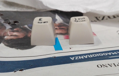

Next i did retrobrite some really yellowed C64 keys
Before
202.08 KiB
183 views
After 2 days of sun.
76.23 KiB
183 views
Same method, 40% cream , brush and sun. I cleaned 'em all and reapplied the cream for a 2nd day of exposure to the Sun, this yellowing was too stubborn.
