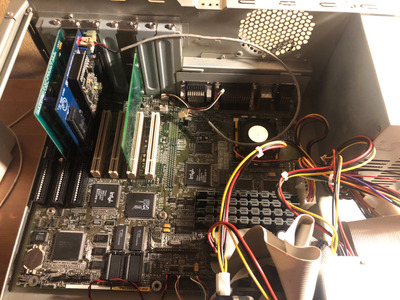

I destroyed a Packard Bell Pack-Mate 7130 in perfect condition, for one. I paid $100 for it. The secondary IDE channel had suddenly went out, and I was going through and checking and double-checking things such as BIOS settings, jumpers on the motherboard, etc. When I went to double-check the RAM, which I had found was very hard to remove due to the little metal clips on the EDO slots being a particular pain, I slipped while using a screwdriver to undo the clip and it went straight into one of the Intel PCIset chip pins. Bent three or four of them together. I have tried unsuccessfully to bend them back, meaning it had shorted pins permanently. It was a Pentium 120 with 16MB of RAM, a great little PC. Oh, well. The case is in nearly flawless condition, no yellowing, etc., and it ran great(ish), and I ended up killing it. I should have left well enough alone.

Option A is to try and get the motherboard in the Packard Bell replaced, as the CPU is fine, the PSU is fine, it's just the motherboard that's gone. The problem is that I can't find the exact motherboard for this model, all of them have less VRAM on the S3 chipset, and they don't have the TV-out and S-Video out ports on them. The motherboard has a generic model of E139761, a more detailed number on a small pink sticker (181410), and a third number on a yellow sticker, but searching that one yielded no results (PSOR62907956).

First of all — I feel your pain. There were cases when I overdid it with cleaning using chemicals, for instance, and ruined perfectly nice plastic parts. There were times when I messed around with DIP cache chips and broke legs on chips. It happens.
Second — I would suggest getting an ATX Socket 7 motherboard. All the I/O is built-in (a lot less cables/breakout panels), the cases are bigger. All in all it's simply a much more pleasant experience when you build a computer or mess around with expansion cards.
Here's my Intel Advanced/ATX motherboard. It's even possible to do some cable management.
1.65 MiB
536 views
All in all I've already sold a lot of my AT Socket 7 motherboards and very close to selling all of them.

Can you take a photo of that Packard Bell motherboard, so we can see the damage? It may be possible (unless the legs broke off) to bend them back with a really sharp object (a needle or something). I've done this a few times and it can give positive results. You won't risk anything since the board is already "dead".

I agree ! Nothing like an exacto knife and small sharp needle to fix those bent smt pins. As long as you have a good magnifying lens it should be no trouble unless you broke a leg near the plastic chip.
