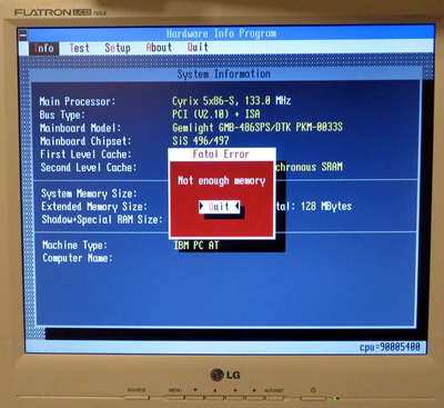

Reply 223 of 884, by feipoa
I receive a not enough memory error, but it no longer hangs. Pressing Q to Quit works now.

Reply 224 of 884, by Mumak
feipoa wrote on 2020-04-16, 07:21:
That's great news finally! 😀
Try to load HIMEM.SYS and set DOS=HIGH, that should make enough memory.

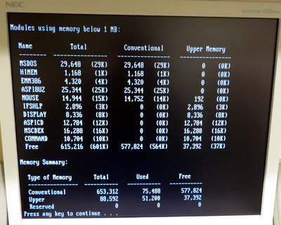

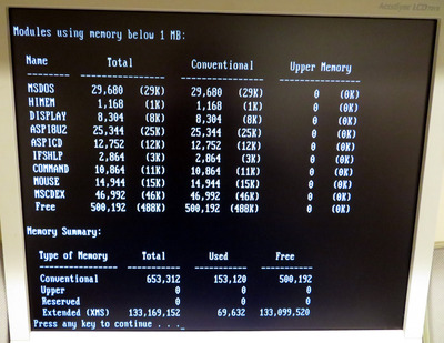

Reply 229 of 884, by feipoa
ASPI8DOS.SYS is the SCSI DOS driver for the 2940UW, while ASPI8U2 is the driver for the AHA-2940U2W. According to the Adaptec readme, these are the ASPI managers/drivers. So not sure why HWiNFO isn't reading the full size of my HDD.
Attached is the screenshot after running mem /c /p
175.81 KiB
1072 views
Why aren't these device drivers being loaded high?
EDIT: I have edited the IFSHLP line to DEVICEHIGH /L:1 =C:\WINDOWS\IFSHLP.SYS , but the same 500,192 KB is free.
Reply 230 of 884, by Mumak
feipoa wrote on 2020-04-16, 11:04:
ASPI8DOS.SYS is the SCSI DOS driver for the 2940UW, while ASPI8U2 is the driver for the AHA-2940U2W. According to the Adaptec r […]
If ASPI DOS drivers are properly installed, the "SCSI info" menu item in HWiNFO should be accessible and provide details about the host adapter and all SCSI devices. I guess something isn't working right here.. When the ASPI driver starts do you see a message that it's correctly installed?
Not sure why nothing gets loaded high, just some clues how I have this set up:
- I specify DOS=HIGH after loading HIMEM.SYS, not sure if that makes any difference. IDK what the NOAUTO switch does, but I also think that UMB has a meaning only for EMM386. I'd suggest to do just DOS=HIGH
- I don't use /L: parameter for DEVICEHIGH, try without it as well.
- You might also add /TESTMEM:OFF to loading HIMEM.SYS, that will speed-up the start. Perhaps remove the /V (verbose) switch to see if it doesn't report some error.
Reply 231 of 884, by feipoa
OK, I have some testing to do then.
I tried it with EMM386 enabled and most drivers load high. Not mouse or ASPI though.
184.71 KiB
1063 views

Reply 232 of 884, by Mumak
Hm, it looks like with pure XMS manager (HIMEM.SYS + DOS=HIGH) only certain portions of DOS can be loaded into HMA. Loading the rest of drivers/TSRs requires EMM386 which are then residing in UMB.
Lot of things that I forgot over the time 😁
