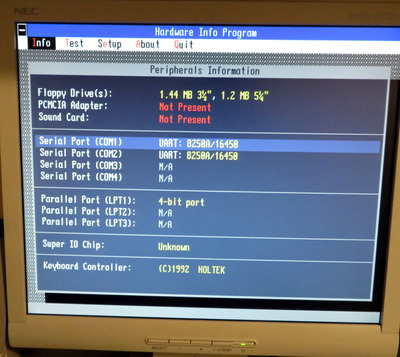

Attached is the report for for SXL2-66 system on the SCREAMER board. Report generation hangs when on Peripherals Information with error: Abnormal program termination Hardware Info Program.
If I run HWiNFO manually, the system hangs up on Peripherals Information and beeps continuously. I am able to view ISA and other devices fine now, but it only shows the 3Com 3C509 network card. the Adaptec 1540 SCSI controller and ESS sound card aren't seen. IRQ's 10, 11, and 12 show up as "free" still but are taken.

Thanks. If you step manually into the Peripherals screen, can you see where exactly it hangs? What's the last entry shown and when it hangs does it show anything in the status bar like "Checking..." ?

This is what the screen looks like at hang.

Stepping manually into Peripherals still hangs AND it goes *beep* *beep* *beep* *beep*... That screenshot I attached is from this event.

Please try to disable the "Check Keyboard Controller and Super IO" option if that will solve the hang on Peripherals.

Yes, if I disable 8042 detection in the ini file, I am able to view Peripherals Information without it beeping or hanging.
