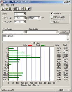

I´m starting to think that SSD doesn´t go well with my desired partitions, no matter how I align and format it. I have a similar Kingston A400, maybe I test that one.
You happen to have any benchmarks of your SSDs?

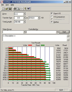

So I did what you said, it didn´t pan out 🙁 Then I just simply did the partitioning and formatting with Super FDisk 1.0 and everything is running smoothly (and yes, I replaced ESDI_506.PDR as instructed). All the drivers are installed, no games though. Snappy boot-up and everything seems to work smoothly. BUT then I ran HDD benchmarks and take a look:
SSD on the left, SD on right. SSDs rates are terrible compared to SD! If this is the best I can get, then it´s better just to get 120 Gb SD card.
Another weird thing: swithing DMA mode on from Device Manager turns performance to shit so boot-ups takes like 2 minutes and desktop use is horrbily choppy.

Are the benchmarks you posted with DMA off for both SSD and SD ?
Is your SD card adapter also going through the the Startech IDE to SATA ?

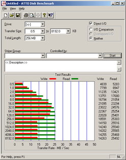

So I tested another another SSD, a 120 Gb Kingston A400. I partitioned a 20 Gb C-drive and a 80 Gb D-drive, same configurations as previously. I ran a HDD benchmark again and... well, see for yourselves:
45.89 KiB
356 views
I don´t know what to make of that...

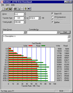

I downloaded that ATTO benchmark you used (thanks Phil's labs) to let you see how SSD's do on my 98se machine.
This is using the onboard Promise controller on my Asus A8v .
Both disks are actually msata cards in SATA adaptors (so they just look like 2.5" HDD's). My C drive is a 60GB and the D is a 120GB. They are a bit slower than real SSD's.
65.21 KiB
289 views
65.08 KiB
289 views

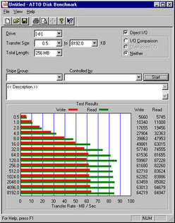

So I changed the 40-pin IDE-ribbon to 80-pin cable and that did the trick! Now DMA works and when I ran the benchmark, the results made me so excited I almost started screaming 😁 Here, look at those numbers and that beautiful cohesive curve!
51.13 KiB
262 views
Now I can finally continue working on my video! You guys have been a tremendous help, without your input this probably would´ve just left undone. So thanks everybody, big thankies all around!!!
