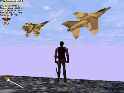

1. to get more fps go from the ship in the harbor through the left gate and to the beach and look at the see, (make a save cause navigating after the next step is a bit different if you don't remeber the map 😉 )
2. lower view distance as much as you can (to get even more fps):
SYSTEM.INI
[xngine]
back_plane=300
(you should have a nice over 100fps now (run game and check 😉 )
3. now you set a 12 fps limit in dgvoodoo2,
and check how the game behaves this way.
Whether it behaves normally or is it in slow motion
i think the game will start too fast, in a seconds slow down to normal, and question is whether it will slow down in seconds second time to slow motion
(sound doesn't matter, just notice whether the sound quality got worse or not)
i already know how to handle the slow motion with preserving high fps in qemu properly but just wonder if dosbox gonna have same effect and if it is a problem of qemu or the game

Reply 59 of 60, by liqmat
robertmo wrote on 2022-06-17, 06:46:
SYSTEM.INI [xngine] back_plane=300 (you should have a nice over 100fps now (run game and check ;) ) […]
SYSTEM.INI
[xngine]
back_plane=300
Not quite 100fps, but with the back_plane set at 300 I got to see a hell of an air show!
