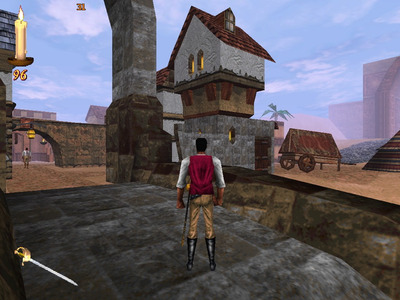

The character animations and engine cutscenes in that game have always been a bit janky when it comes to FPS counts. As far as the overall FPS in the game it takes a bit of raw horsepower to get a decent FPS on a modern system. This was a screenshot from my 5900X coupled with a 2080 GPU (FPS on the low side in a city, top left corner). I bottom out at about 29 FPS in complex scenes, but not too often. I usually see numbers in the 40s and 50s on average with that rig. When i first bought the game from GOG it was almost unplayable. Upgrading nGlide to a newer version didn't do anything for me either. In hindsight, I realize now this game was pretty sluggish on release (at least on my system) and now on an emulated OS and emulated Glide I suppose it's a small miracle the thing runs as well as it does. Still not the worst Bethsoft title. One word. Battlespire. Should have called it Bugspire.

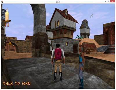

btw there's a building missing on your picture 😉

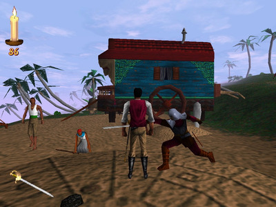

Mixed bag. Environmental sounds fade in/out with distance normally. The guards sound loud far away or close by, but the woman praying in the screenshot fades in and out appropriately. (yes, I am being fiercely pierced in that shot)
As far as the missing building, it's not missing, but has always been out of view (behind the distance fog) from that location. Maybe you have yours setup differently? Mine is vanilla install from GOG. No idea.

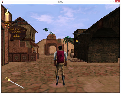

here is the location when you can try turning around again and again and every time the game will pause for hdd access 😉

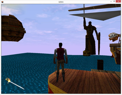

here is why distance sux in this game, notice how close the observatory is from the harbor, how small the map actually is, well, no horses just running, but looks so big when you don't see other side of the ocean 😉
