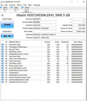

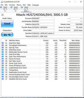

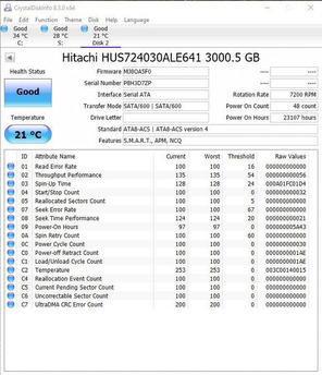

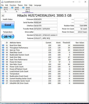

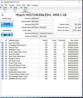

Thanks for the advice all. Taking everything into consideration.
A seller local to me has some 3TB SATA drives for sale cheap, they were apparently Newegg "refurbs" that they personally didn't end up using. They were kind enough to get the SMART status for me:
I'm aware of the high power-on time, but honestly, some of the ones I'm backing up (which are primary data drives in PCs I use daily) are well higher than that. Again, money is super tight here, our dollar is low, and shipping to my island is usually a complete ripoff, so these have a BIG bonus of being local. I'm trying to do something on a shoestring that'll serve me for a couple years, not develop the perfect backup solution to last forever.
97.67 KiB
310 views
95.51 KiB
310 views
97.87 KiB
310 views
94.71 KiB
310 views
99.93 KiB
310 views
What strikes me as odd is that a lot of the stats are exactly the same - e.g. spin retry rate, seek error count, reallocated sector count, etc. I assume they all came out of the same RAID array, but even with that caveat, shouldn't these numbers vary a fair bit?
I would put them into RAID 1 and keep one drive as a spare, not RAID 5. Do you guys see any red flags here?
