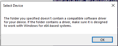

Reply 38 of 82, by darry
sergm wrote on 2020-06-03, 19:56:
It appears, windows isn't that strict at security as we assumed, it just made the process of installing unsigned drivers as anno […]
It appears, windows isn't that strict at security as we assumed, it just made the process of installing unsigned drivers as annoying as possible... 😀
We can choose to reboot windows in the "unsecure" mode, so it will simply ask the user whether he wants to install an unsigned driver. Also, one now needs to start the wizard capable of installing drivers for non-PnP devices from the command line (or the Run box), making it even simpler 😀
We start our quest from the new control panel (yes, the other control panel which is called "Settings"). In the Update & Security, go to the Recovery pane and initiate the Advanced startup. When it reboots to the boot loader config, proceed to the Troubleshooting / Advanced options / Startup settings. After yet another restart, we'll be able to switch the desired "unsecure" mode by pressing key F7 or 7 and windows will boot up. Nice eh?
BTW, this mode will last until the next reboot only. But while it is active, we can make the driver installer finally do its dirty work. Fire hdwwiz.exe, this is the old and the coolest hardware install wizard, which allows to install drivers for software-only devices like mt32emu, and point to the directory with the unzipped driver via the Advanced / Have Disk options. After all that, things go blazingly fast, and the driver will start to work in a second.
A long way indeed. I'll be seeking for better choices yet, at least the hdwwiz.exe step should be possible to eliminate using an automated driver installer.
Thank you .
I tried it, but when I point the wizard to the folder with mt32emu.inf ( C:\Program Files\munt\mt32emu_win32drv ) , I get
6.47 KiB
2642 views
I am using a 64-bit version of Windows 10 Pro build 2004 .
I have attached the directory with the driver in case you need it .
mt32emu_win32drv.zip
340.63 KiB
86 downloads
GPL-2.0-or-later
Reply 39 of 82, by sergm
Oh, of course the .INF file from the driver distro isn't meant to work, it is 32-bit only (since it's the platform when it "just works"). I'm hacking on a 64-bit version.
