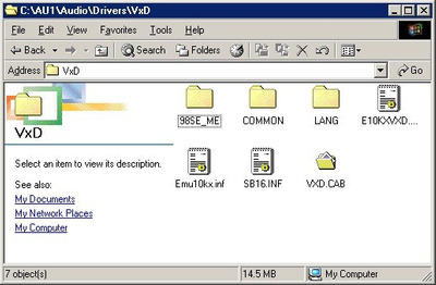

Reply 138 of 209, by Vanessaira
I seem to be stuck at the moment. I am to the part where you install CTZAPXX, but it only has WDM option selected. VXDs are greyed out. I am unsure where you want the VXD.cab file extracted. I extracted it all from the CD to the HDD in C: and made a folder where I put everything together including the CTZAPXX file and everything accompanying that on the CD into one location. I am using real hardware, real CDs etc.
V
An Analog Girl in a Digital World
Reply 139 of 209, by Joseph_Joestar
Vanessaira wrote on 2023-01-15, 09:43:
V
The contents of VXD.CAB should be extracted to this folder:
C:\AU1\Audio\Drivers\VxD
After that, CTZAPXX.EXE should be able to pick them up during installation. The fully populated folder should look like this:
40.31 KiB
1265 views
It's weird that Creative decided that VxD drivers were such low priority at that time that they never bothered to decompress the archive on the CD. Not like it was lacking storage space.
