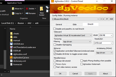

First post, by pprandom
I can't seem to disable it; i'm using the launcher and appling the watermark check mark off. The folder is C:/illusion/AA2/edit or /main and i'm using the d3d9.dll that reduces lag that was posted in these forums. I think there's something i'm not getting right in the wrapper coinfiguration.

Reply 2 of 7, by Dege
Are you using the D3D9.DLL from 2.63.2? Or just the old prototype version I made before integrating it into dgVoodoo (I hope not)?
2.63.2 should work, only you have to change in the config is DirectXExt\'Max VS const registers' set to 1024 + watermark disabled (by either manual text edit or enabling all config sections in the CPL by a right click somewhere).
Reply 3 of 7, by pprandom
Thing is that the d3d9.dll that comes with the last version of dgvoodoo doesn't remove the lag for the game, i don't even know if it's being recognized.
The only one that works, even without the wrapper program is the dll posted here: Artificial Academy 2 with dgVoodoo2 Special build
but i don't know wich version of the program is made for.
Reply 4 of 7, by Dege
It works for me. Copy d3d9.dll from the MS\x86 folder, copy dgVoodoo.conf to the game folder and set option
MaxVSConstRegisters                 = 1024
You can also set
dgVoodooWatermark                   = false
to disable watermark and that's all.

Reply 7 of 7, by Dege
Copy the attached config file into the game folder (where d3d9.dll is). It should work, it works for me.
