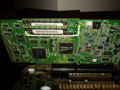

I'm also have an EMU8k burning up on my CT3930. It's @ 82.6 C ! Looks like at least 2 other people confirm this IC405A gets very hot. @ TheMobRules, how hot does yours get? Hot or not hot, this card isn't detected by Windows 98 at all. It did get detected for a day or 2 right when I 1st plugged it in, but I never installed the drivers to test because I was overcoming other issues like the graphics card not being able to output a high enough resolution that the monitor supports.
I've tried blowing away any debris that could be causing a short circuit. 1 other thing I noticed are 2 green jumper wires at the bottom edge of the card, suggesting this was an early PCB revision. Does anyone else have that?
Am I out of luck?

I haven't measured temps, but I can tell you it gets scorching hot after a short while, I can't keep my finger on the chip for more than an instant and I can feel the heat radiating to the surrounding area. The card does work fine, including the AWE Synthesized Music, but I haven't used it long enough to test long term stability.
Keep in mind that the CT3930 is a rare specimen of SB32 as it sports a Vibra16 chip, Genuine Yamaha OPL and more importantly is non-PnP, which means that it must be manually configured with jumpers and it will not appear as a PnP device in Windows 9x (and may not appear at all unless you tell Windows to scan for legacy cards). I'd suggest you test on pure DOS just to be sure.
By the way, my card also has the green bodge wires near the chip and it's marked IC405A as well.

Keep in mind that the CT3930 is a rare specimen of SB32...
Yes, this is a very precious card ! I got it off of eBay for no more than the much more common CT3600. But unfortunately, I didn't get to test it until after the return period expired because my motherboard (ASUS CUBX-E) ordered from Germany didn't arrive until 1 month later 🙁
OK, so there might be some hope if it can be detected in DOS if the jumpers are changed. I'll try that

Reply 18 of 20, by spacesaver
OMG, it all works now, but only from DOS. Thanks for the tip @TheMobRules. Big payoff, we got Dick Tracy out of the way... I've put a heat sink on. Temperature is much better now (50C).
I'm really relieved the card was OK all along.
