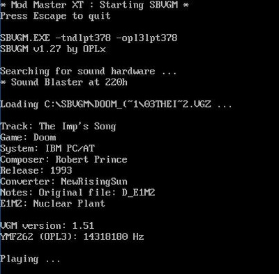

FreddyV wrote on 2020-09-07, 19:46:
Elbrunzy,
This is what I did first. The currently released mod master can be used to play vgm files with sbvgm and we can do a playlist.
Now I am adding vgm format for opl2 opl3 and tandy. If it fail to load, it use sbvgm.
Hi,
I added this for you and it is a good idea:
29.52 KiB
1802 views
IT is passing the Devices config done in Mod MAster to SBVGM.
I noticed that if we have an onboard OPL3, the OPL3lpt argument seems to be ignored.

Reply 65 of 133, by FreddyV
ElBrunzy wrote on 2020-09-12, 18:22:
oh wow, if this is working great I will have to report it to oplx on his sbvgm thread. It's been so long since we been looking for a frontend to listen to vgm using the payer. I'm surprised it does not work using cubicplayer and pretending .vgm/vgz are kind of archive and sbvgm is the decompressor... anyway, we are all using a batch file for each .vg? loop and it's subpar so your solution is very welcome, I think you can even save/load playlist, right ?
You should talk to oplx about the command line problem, but I'm pretty sure it's normal. His command line interpreter is nothing but intuitive, and while it's probably the expected behavior, maybe it is not or you found a situation. I would ask him on his own thread if I where you, I'm sure he would be pleased to check it out. Also, you did not explained me how to reach the synth/wave config menu, I've read all doc, onscreen help and try many shortcut but have not find it yet.
Hi,
It is in the b21 version I just released yesterday.
For the "Synth" Menu: When you are in the output menu, press Tab or click on Synth with the mouse.
(Or Press t then Tab)
OPL2LPT is normally supported (Not Tested)
OPL2LPT Not supported (I Wanted to know if OPL2LPT Work first)
TDYLPT Should work
For .VGM, IMF, DRO, RAW files

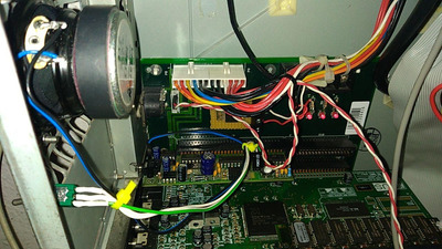

Reply 78 of 133, by matze79
Here is my Card installed in my 486:
74.23 KiB
1528 views
167.4 KiB
1528 views
A Speaker + a 3 Pol Switch.
The Switch is used to Switch from 2C0h to 0c0h when i play Tandy Games.
And back to 2c0h for conflict free Operation afterwards.
