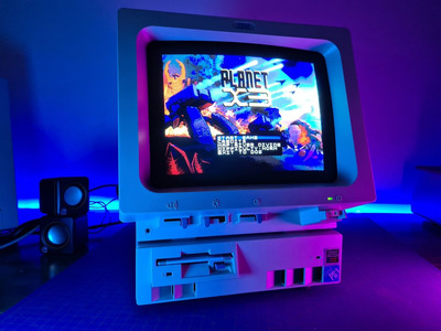

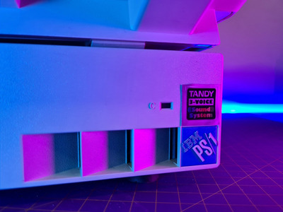

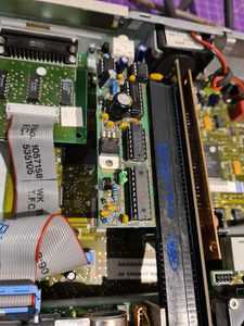

Thanks for making this card, I made a little 2 slot ISA riser for my IBM PS1 2011 and it works fine. A few issues when not initialised , and the TSR wont run on the the IBM but games that support the Tandy sound work .

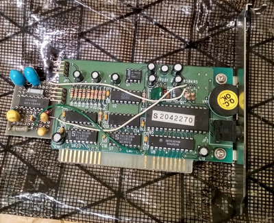

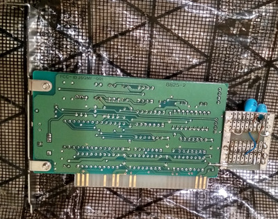

This is not a new build, but in my collection there is a Preton Technology (Adlib clone) ISA-8 soundcard which someone has modified by adding a small home-made PCB to it (for enhanced amplification, I think).

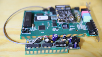

On the v1.0 card I hooked the ground to the lower (the one next to "C12" silkscreen text) pin of C12 (which is really R2), L+R are before the added 10k resistor (between the pcboard and the resistor) at the middle leg of the 10k trimpot. Thus providing a safe line-level to the host card via a molex mpc2 audio connector.
545.24 KiB
1549 views
Here you can see a tndy nano v1.0 connected to it's host soundcard. I'm not sure what is the added value of this document but I like this kind of geeky stuff.
