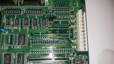

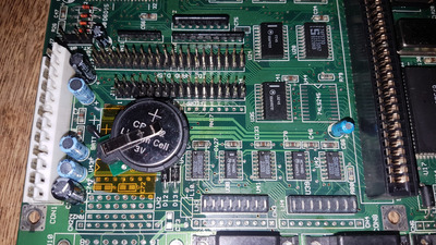

I've been working quite a bit on my Mega PC the last few weeks trying to repair the damage to my board and get my floppy drive working..
Here's what I found under the Floppy header

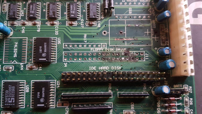

After some cleaning I managed to trace all tracks and repair 3 broken VIA's with small pieces of wire, then I took off the HDD header..

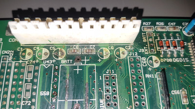

It had 1 VIA that was broken too which I repaired.. taking off the caps and ext batt header revealed more mess, this was mainly electrolyte gunk but a small bit of acid residue too, luckily no damage
1.56 MiB
3227 views
This is it all repaired ready for new components
2 MiB
3227 views
And finally all finished with a new Battery (Its an Amigakit adapter with a Diode inline)
1.67 MiB
3227 views
It all works great now, no need to reset the BIOS all the time, and I can finally use floppy disks 😀

I'm interested in the coin battery holder and whether it's safe to leave the battery in place long term within the case. I removed the old leaky battery which fortunately hadn't done too much damage but have been paranoid about leakage as a result. I've been using a little battery holder that takes 3 AAA batteries and connects to the ext.battery pins on the board without soldering (next to the IDE cable attachment) as per photo. It's ok but I don't like the way I'm having to mismount the ISA cover to thread the cable outside the case just to keep the batteries away from the board so if it's safe to mount them long term within the case as you've done I'd be interested?

@smsdave, the CR2032 is removable so if I decide to ever put my Mega PC in storage i'll just take it out. The diode protects it from being charged whilst running so no danger there either. I had to modify the adapter from Amigakit.com and add a wire to make it fit. Its a nice solution overall, i'd recommend it if you get fed up with the battery box.

I've also ordered the CR2032 battery adapter, do you have any photos more details of the modification you ended up making so I can follow what you did?
Reply 130 of 228, by phipscube
@smsdave,
That XT-IDE will do the trick 😀
I took out the two positive pins and soldered a wire to one of the vias... the negative pin solder directly into the farthest of the two points on the Mega PC mainboard, on a slight angle like I have. Put some tape under to avoid shorts. Then solder the wire into the positive point. The battery holder will then just rest nicely in place.

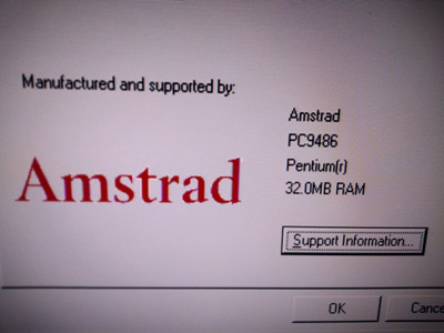

BTW have just recovered a Amstrad 9486 from a recycling fate - unfortunately its not the 9486i version with PCI, but still a good dos system and with a Pentium Overdrive installed its a good compliment to my 3086 and Mega-PC (perhaps another thread one day). For anyone with Win95 on your Amstrad (which this machine has), I've attached some OEM info files to give your Control Panel the Amstrad Branding (remember they need to go in the Windows system directory)
Amstrad_WIn95_OEMINFO.zip
4.52 KiB
95 downloads
