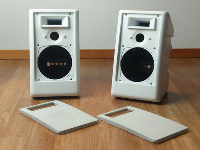

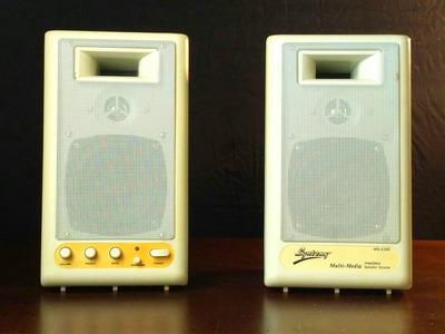

My cousin got these hideous things in 1997, I was super jealous. Now his mom gave them to me, so it was really worth playing the waiting game...
1.18 MiB
208 views

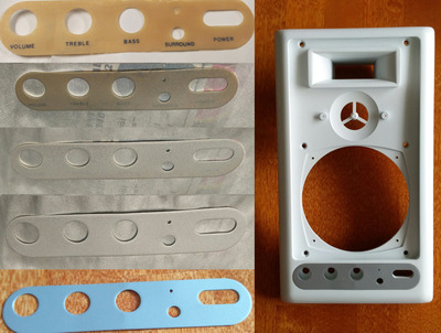

First, these boxes needed some coarse love so I thoroughly sanded them down before painting them with bright white. Here the frontpanels are still waiting for the sweet new coating, you can see how big the shade difference is. Also, note that the panel in the right use to have same holes as the left panel, but managed to rip the cover label in half so I decided to fill it with plastic putty.

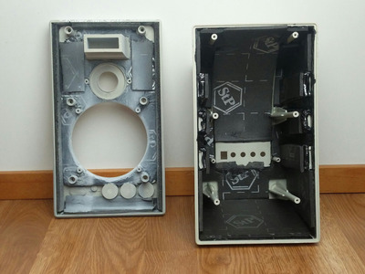

First, let´s talk about the step forward, which is the damping. It´s not a secret that computer speaker boxes from the 90s are acustical nightmares. They vibrate like crazy even in low volumes and low frequencies sounds hollow and inaccurate, generally just awful. I used 1,8 mm thick STP Silverline damping mat to add some weight to the surfaces, and on top of that I added 8 mm thick STP Splen 08 for noise absorption.

In addition to deadening, my original plan for these speakers was simply just to improve the aesthetics of the boxes, and keep the original tweeters and woofers. I painted the boxes bright white and the label in silver.

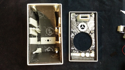

I added a little more dampening. There´s a little paint on the dampening of the front panels because I had to paint them again.

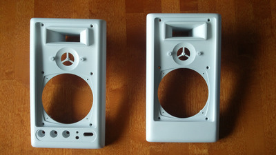

Due to setbacks of the previous post, I had to rethink this whole project and decided to turn both boxes into passive speakers. I filled the holes with plastic putty, trimmed them with spray putty. This isn´t as easy as it seems, it takes a LOT of patience! I took my time with the prep work and it finally paid off.
