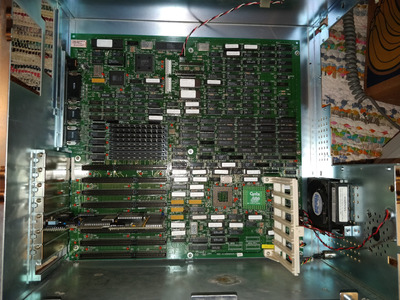

A while ago I got an old 386 just because I wanted some parts of the case for another build. Since it would be a shame to waste a perfectly good (ehum) 386 I thought I should give it a chance to live again.
What we have is a Facit S333T, orignally a 386 DX 33 but upgraded with a Cyrix cpu, probably running at 66mhz.
Looking at the date-codes on the components it probably from 1990. Can't really get any more clues about model/manufacturer from looking at it an trying to google any of the info i have from the card doesn't give any hits. Other Facit-computers I have had thru the years has been produced by Mitac but I don't see their name anywhere on this model.
Onboard IDE, floppy, serial and parallell port
8 SIMM sockets
8 ISA slots
non standard AT-connector, not ground in the middle
external battery (not leaking!)
128k L1 cache (is that even possible on a 386?)
unknown memory size. Speedsys reports 22mb, bios says 8mb.

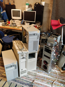

Case on top in the middle.

Motherboard

PWA 4000WB. Looks like an Everex model name to me. It's a pretty sweet board...TTL logic. No chipset. 128kb cache. Plus you have a DRx2 33/66 in pristine condition with original heatsink. That's rare. That case is amazing too.

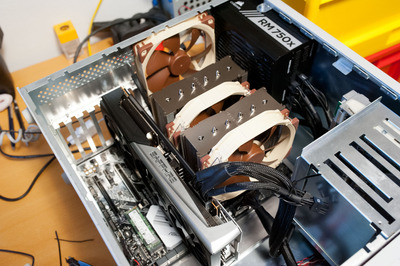

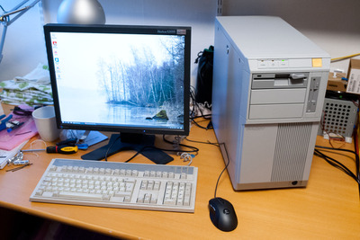

The case has a history of its own. My first PC had the same case for many years, it ended up with a Pentium 133 in it before it got converted to ATX and still serves as a backup server that my father still uses.
So I did another build with the same case design that I converted many years ago... now with a slightly faster components.

That seems to be the penalty to being to market early with so much cache. The design costs of that board must have been enormous, look at the nearly 30(!) GAL/PAL custom logic chips (recognizable by the paper label indicating the program). The production costs of a board that big are also considerable. There were 386DX chipsets in 1990, for example I remember the Intel 82385 cache controller in the Compaq Deskpro 386/20 made in 1988 already. But that cache controller only support 32K of mainboard-level cache. I also thought about the Intel 82346 system controller, a rebranded VLSI 82c330 (aka TOPCAT), but at least the Intel version was announced in 1990, so not finding it on a board produced in 1990 makes sense. The C&T CS8231 also comes to mind, but I couldn't find the release date readily available.
It's interesting that you find 2 50ns-delay lines (with 5 taps each, as usual, so 10-20-30-40-50ns) for memory timing generation. This might be a hint towards bank interleaving. So I guess that board was top notch in 1990.
