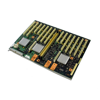

The attached picture shows the I/O board of an IBM 7026-H80 with 64 Bit 66 MHz slots.
This is the box with the most PCI slots I own, but still no PCI-X.
