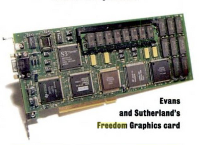

I've recently got myself a '95 workstation OpenGL acceleration card that's using an Evans & Sutherland Freedom chip. It came with the drivers for WinNT 3.51, but I'm trying to find drivers for WinNT 4 or Win9x if they exist at all. So far I've tried Archive.org and Google Groups, but came up with nothing. Archive.org only has copies of es.com site from 1998, where Freedom is not even mentioned.
I've tried installing the WinNT 3.51 drivers under WinNT 4.0 Workstation, but it said that the drivers are incompatible.
hj7C3i6m.jpg?1
Does anybody have any relevant files or info on this card?

Freedom Graphics was initially showcased during Fall Comdex in 1994 (November). The card was scheduled for a release sometime around March 1995, after a delay the last mention of a launch was August of that same year – I am not entirely sure when or where the card made it to market. The card got a bit of press coverage in the context of VR during 1995, the hardware was exhibited with one of E&S’ in-house game demos called Midnight Manor. PC Magazine’s March 14, 1995 edition (p183) briefly discusses the cards capabilities in a paragraph alongside a picture of what seems to be an earlier version of your Park City board.
514.32 KiB
369 views
Direct link to magazine and page:
https://books.google.com/books?id=79i1lfAqumU … epage&q&f=false
E&S’ 1996 fiscal year report reveals the company was experiencing issues during the mid-90’s: fierce competition in several markets as well as restructuring (i.e. reductions in all business groups). According to this report, sometime in 1995 E&S eliminated the entire Freedom Series product line, because it was not profitable. Hardware and software support seem to have continued across the various platforms and operating systems for some time – judging by the documents, press releases, and announcements put out by DEC, HP, IBM, and Sun.

Thank you for reaching out! Don't have any good news, unfortunately.
Well, I did try several things, but so far I haven't been able to find newer drivers.
- contacted Evans & Sutherland. They've responded by saying they've long sold the graphics business, but someone might have some archives in Collins Aerospace office in Salt Lake city. I've tried looking for people who worked at E&S on LinkedIn, sent some requests — no luck.
- like you, I've tried looking for vendors that shipped their computers with E&S. DEC's site isn't available on Archive.org, HP.com is semi broken. I did manage to find some mentions of HP Vectra workstations using E&S cards, but it looks like they used later REALImage cards, not Freedom. AFAIK, IBM didn't use E&S on x86 machines.
- talked to some professional graphics cards collectors, but I haven't found anyone with a Freedom in their collection, let alone drivers for it.
I've got my hands on a cheap Intel PR440FX motherboard yesterday (dual Pentium Pro). Pretty useless thing for games, so I might as well turn it into a Windows NT 3.51 workstation once I find some EDO-DIMM memory. Too bad 3.51 can't run any OpenGL games (that I know of), but there is no guarantee that Freedom can run Quake, either.

According to this press release, Win9x drivers was planned:
PRESS RELEASE
"EVANS & SUTHERLAND BRINGS 3D GRAPHICS EXPERTISE
TO THE PERSONAL COMPUTER
SALT LAKE CITY, March 2, 1995
Evans & Sutherland Computer Corporation (NASDAQ: ESCC) today announced
