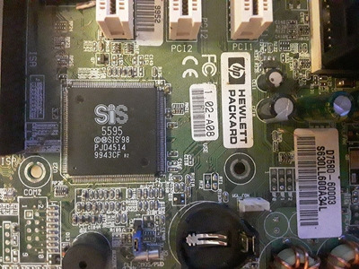

I'm looking for any driver that will work with a 5595 SIS chip set in Win 3.11. I have tried every driver I could find on Vogons Graphic Drivers and the SiS website with no luck. I would be happy with any generic driver that would give me 256 colors. This is an On Board video card that I can't pin or use the bios to shut off. If that were the case, I would just put in a different Vid card. I also have a multi boot that is running, WIN 95\98\2000\XP. This Vid card works on all other loads.
If anyone has a driver or knows of one that may work please post a link. Edit: In case it helps, the card shows as SiS 530/620 in Win2000Pro

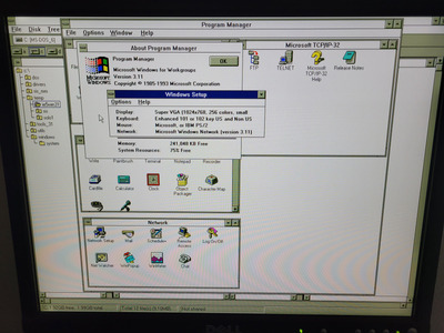

There are patches out there that try and add VESA support to the SVGA driver included in WfW 3.11. Try SVGAPatch from https://www.japheth.de/dwnload1.html or the one from here (which is designed for VMware guests but may work anyway) https://sites.google.com/site/chitchatvmback/misc
I've found these to sometimes have issues switching to and from fullscreen text mode, so you might want to edit _default.pif and any other .pif files in the windows directory to run in a window instead.

The 5595 is a southbridge with various I/O stuff, but not the UMA VGA controller. That's integrated into the northbridge, in this case either 620 (Slot1/So370) or 530 (So7) northbridge. Both contain an integrated AGP 6326.

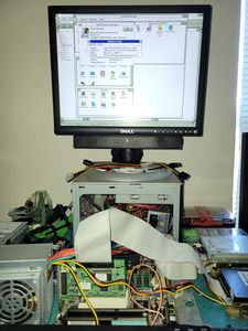

I have a Gigabyte GA-S5MM mobo that I pulled from an old Compaq system (I can't rember the model though) and it has this same chipset/gpu.
I reflashed it to a stock Gigabyte bios from their official site ( though I also forgot to back up the Compaq bios though it was worse in every way due to artificial feature limits and only smaller HDD support) , then I installed DOS 6.22 and Win3.11 WfW and ran into the same issue as Compenstine did.
I did try jakethompson1's suggestions about using "SVGAPatch" and it seems to have worked as I can set it to 1024x768 with 256 colors.
I'm guessing it's purely a driver issue with the SIS 6326 as the options seem correct in their SVGA setup tool but I've tried every option there at "60-75 NI" and all of the failed to show up on my old Dell Ultrasharp 2001FP LCD monitor atleast, though I haven't set up a CRT monitor so it's possible those might work.
