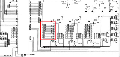

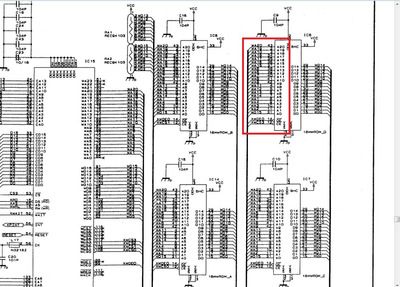

So, without first we figure our how the PCM data are addressed in SC55ROM, it will be kind of impossible to figure out how they are encoded in SC55ROM Waverom.
Unfortunatly you are right. If we take a look on schematic, every IC (IC26/7/8) has his own CE (chip enabled line). The waveform roms are 8 bit. So even if SC55 uses 12 bit of sample, the additional 4 bits (to 12 bits) doesn't come from the same rom chip. With focus on performance issues, it could be possible, that at every sample 2 CE-lines are enabled. To save time in such an old embedded system, the additional 4 bits should be in a different rom at the same adress as the 8 bits from a given sample, because changing adress lines costs a few micro seconds.

Unfortunately NewRisingSun adress-decryption works perfectly on SC55 SF rom-chips but doesnt't work on SC88 soundfont. One of the the reason would be, if we take a look on both service-notes schematics (SC55 & SC88), that in schematic of SC88 the adress lines are mixed up per se. My SC88 is in thousand pieces, roms are soldered on self made pcb's for read-out, so logic analyzer adress-descrambling is not possible.
It would be nice, if NewRisingSun hase some ideas.
    194.55 KiB
    2151 views
    224.7 KiB
    2151 views
Reply 138 of 377, by yawetaG
The SC88 also has other IC differences from the SC55, such as a different CPU (incidentally the same as used in the JV1080), so different addressing might not be too much of a surprise.
