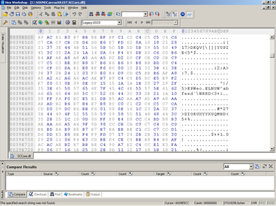

OMG, it looks like "block2" data are stored unencrypted in Roland Sound Canvas VA VSTi Plugin - 20 years newer software, but less protected than VSC 1.x from 1996, is that for real?! Also, they are packed the same way I explained here:
Re: About Roland Virtual Sound Canvas 3
    49.37 KiB
