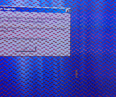

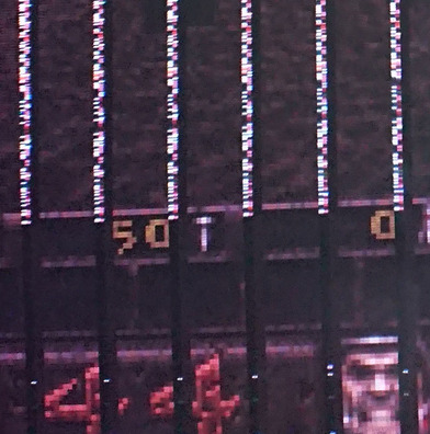

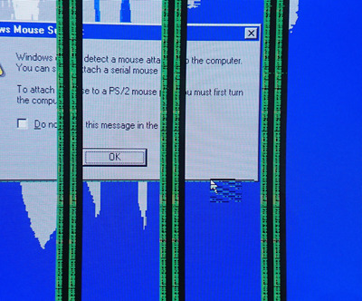

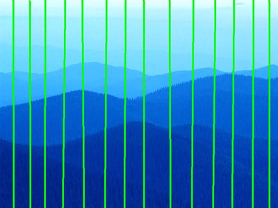

So I have a few geforce 2,3,256 etc cards that display have vertical lines, or stripes. It varies in severity per card. I read this is usually because the vram has gone bad. But I do not know enough about fixing these cards to know any better. Would soldering new ram on a card with those kinda problems fix them.
geforce 2 ultra that has thin Vertical green lines
GTS Pro has Vertical bars.

Can you take a photo of the output? What do the caps look like on the boards? I have a board similar to what you describe.
If you have the issue using the dvi port on the card to a dvi port on the monitor (all digital) then it's not the ramdac I guess.

Reply 10 of 18, by Warlord
well my suspicion is bad ram chips, since there is 8 of them on my 256 it's impossible to know which one or ones. I'd have to find a couple donor cards with the same ram chips. Re flowing bad ram i doubt will help.
Normally I wouldn't worry about it, but its a rare card.
Reply 11 of 18, by The Serpent Rider
If problem is visible only on viewport and there's no direct corruptions in 3D graphics, like strange textures, then it's not VRAM.

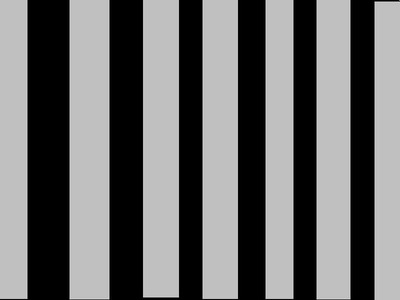

Found this site. based on the screen shots my cards are probably ram related.
http://www.playtool.com/pages/artifacts/artifacts.html
Early geforce cards used normal sdr or ddr the 256 DDR will be easy to source doner ram. I'm not as sure about the geforce gts ultra.

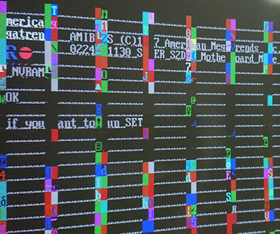

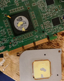

Victim #2- TI4600 with this issue:
423.32 KiB
257 views
1st issue quake
1.2 MiB
257 views
1st issue
Tried Shamino's trick kind of and what do you know putting pressure on or around the bottom memory pad not only changed the artifact colour but after a reboot temporarily made it disappear.
Sadly this behavior was short lived first showing a new artifact as below then going back to the same artifact and no pressure later on would change it.
1.56 MiB
257 views
2nd issue
At least there was hope that it was fixible. Took off the heatsink, note to all Ti4600/4400 FX5800/FX5950 users... your TIM pad is basically like dried gum by now and needs replacing. The heat gun and a scraping device was needed to remove it.
1 MiB
257 views
TIM
Preheated the board with the heatgun moving around the core, then made sure to raise the temp to the point solder melted on top of the core (my temperature test) just a bit + 10secs more heat for good luck. Let it cool for 30 mins at least.
What do you know Ti4600 working happily and all games working fine! Of course no idea how long it will last.
1.82 MiB
257 views
fixed
Having experienced the temporary reprieve described earlier and combined with the fact that the artifact is a uniform 1/4 ish of the screen tells me this was VRAM related. However, my guess is that the actual root issue is the cooler, as the TIM dries the core dumps more heat on the PCB (you can really feel the difference by putting your finger on the board behind the core before and after) warping the PCB it as it cools, heats and repeat with use.
Over time some issue between the core and the VRAM chip occurs, in this case maybe a corresponding solder ball at the peripheral of the GPU chip (not sure if pressing around the VRAM would influence this or not). By cruedly reflowing the GPU and fixing the cooler issue it seem this one can live on a bit longer.
Sorry for the essay, wanted to share in case it helps others. 👍
