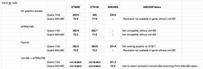

Quick and dirty test of these cards, as they often come up in DOS PCI card conversations. Might be useful for some folks.
Other people have done much better testing but maybe not including all 3 on the same system.
Benchmarks taken from Phils DOS benchmark.
The cards:
Jaton Video Magic 128 (ET6000) 2MB MDRAM
Apocalypse 5D (ET6100, PCX2, DEC PCI Bridge) 4MB MDRAM
Legend 64 (ARK2000) 2MB VRAM
Test System:
AOpen AX3S Pro-U (815e B stepping chipset)
Pentium III-S 1400
2x 256MB Infineon PC133 2225 modules
Athlon XP S462 cooler, nothing special
No sound card installed, onboard sound disabled
Tualatin 1400 @ 1400MHz/1.45v/10.5 x 133.6MHz Bus/133MHz 2,2,2,5 SDRAM/33MHz PCI
Codeblock version
                                        ET6000             ET6100               ARK2000
No graphics booster
Quake VGA 243.8 245.0 236.0
Quake 640x480 72.4 71.9 (Need UniVBE)
MTRRLFBE
Quake VGA 252.9 252.7 Not compatible with MTRRLFBE without UniVBE
Quake 640x480 72.2 71.9 "
Fastvid
Quake VGA 252.9 254.9 231.9 (Doesn't work properly on 815E?)
Quake 640x480 72.3 72.2 (Need UniVBE)
UniVBE + MTRRLFBE
Quake VGA not tested not tested 231.2
Quake 640x480 not tested not tested 78.6
Table screenshot
64.49 KiB
696 views

Performance conclusions
ET6000 vs ET6100 performance is negligible unless the PCI bridge is holding back the ET6100. edit - ET6000 struggles at SVGA, possible due to 2MB althought the ARK does well also with 2MB.
The ET6100 does pull away just a small amount when the CPU is overclocked, checked several times with reboots.
The ET6100 didn't seem to under perform with the PCI bridge like some people were indicating, the Apocalypse 5D sonic might be different?
ARK2000 comes close in non enhanced performance but has some VESA 2.0 and fastvid issues that may or may not be resolved with more time UniVBE fixes this.
This combo of 815E chipset and Tualatin 1400 benefits only a little from DOS graphics boosters and has good PCI performance for these limited tests. (My 440GX system shows much bigger gains from using boosters)

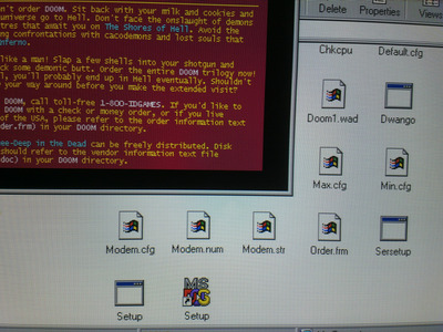

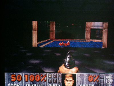

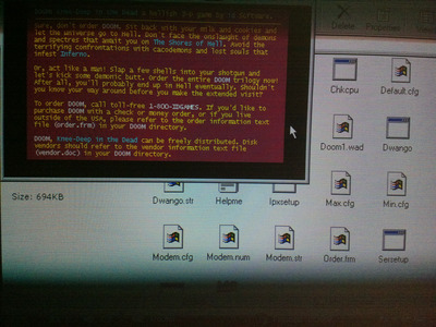

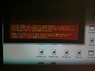

Reply 2 of 20, by Hanamichi
RAMDAC quality photos below (hard to capture on a CRT).
Nokia 808 used.
You can (just) make out the vertical lines and a bit of green/grey overtone on the ARK.
ARK2000 WIN

ARK2000 DOOM
1.1 MiB
721 views
ET6000 WIN
1.31 MiB
721 views

ET6100 WIN
1.58 MiB
721 views

Reply 3 of 20, by The Serpent Rider
You need SciTech Display Doctor aka Univbe for ARK2000. It won't hurt for Tseng cards too. You may also want to bench Quake with vid_nopageflip "0" or "1" command, which may improve performance. Also vid_wait should be set to 0.
I would place both the Tseng RAMDACs above your bog stand NVIDIA RIVA
Any Riva card has superior DAC - 230 Mhz or more.
