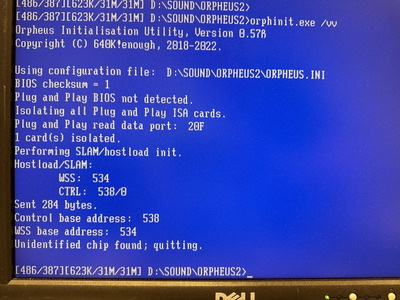

I've just started playing with my OrpheusII, and I'm getting "Unidentified chip found; quitting.".
Using default .ini file. This is a non-PnP system. Only other card installed is a 3com 3c509 (Etherlink III); I can try to change its IRQ and port (currently 10 and 300), but doubt that will make a difference..?

Reply 130 of 169, by 640K!enough
ltning wrote on 2023-06-10, 22:49:
Something strange appears to be happening here. If you don't mind a little bit of collaborative, back-and-forth trouble-shooting, we should be able to get the issue(s) sorted. Just to confirm, we are dealing with Orpheus II, rather than Orpheus II LT, correct?
You mentioned that your ORPHEUS.INI is the default file. Did you make sure to set the cardType correctly? Please double-check this, as it is still mandatory, for now, to get the card working correctly.
To get a better idea of what we're dealing with, there are two things that would help:
  1. A more complete description of your hardware configuration.
  2. The full debug-level output from ORPHINIT. The easiest way is to issue the command ORPHINIT /vd > ORPHINIT.TXT then post the resulting ORPHINIT.TXT file.
Reply 131 of 169, by ltning
Hey, thanks! Happy to ping-pong :) But I'm not physically at the machine until later today. If you're on IRC or Discord or the fediverse or something, we could do "real-time" ping-pong if you'd like.
640K!enough wrote on 2023-06-11, 03:38:
Yep, this is the full Orpheus II.
I started out with version 0.54, then upgraded to 0.57 and tried with both my old (slightly modified, volume settings and WSS IRQ only) and the new (straight from the ZIP) .INI files. Both versions, and both INI file variations, produced the same result.
And yes, the cardType is set correctly in the 0.57 .INI by default.
  • A more complete description of your hardware configuration.
So the motherboard is something similar to a TK TK83305-4N-D-03. I say similar because it's not a perfect match for
https://theretroweb.com/motherboards/s/tk-tk83305-4n-d-03
but either way BIOSes and such are interchangable between a lot of these boards. I'm using the AMI BIOS from TRW.
CPU is a TI 486DLC-40. Cyrix 3x87 FPU. Chipset has 8KB built-in L2 cache. ISA bus speed set to CPUCLK/5 (so <40MHz), and plenty of cache read/write wait states configured (to make sure this is not an issue). 32MB 60ns RAM.
Other hardware:
- 3c509, IRQ10, I/O 300, 8KB XTIDE at C800H
- UMC HDD/FDD/IO: IRQ14+15 HDD, FDD, EPP and one serial port enabled with standard config
- ATI Mach64 2MB DRAM
  • The full debug-level output from ORPHINIT. The easiest way is to issue the command ORPHINIT /vd > ORPHINIT.TXT then post the resulting ORPHINIT.TXT file.
I can get you that later, when I'm at the keyboard :)

Reply 132 of 169, by ltning
Attached.
Without a baseline I don't know how this should look (I'll test my other card in another machine in a bit), but one thing caught my eye:
PNP_isolate_all_cards() begin.
1e560001 CSN: 1 Isolation result: 0
00000000 CSN: 1 Isolation result: 4
Is it possible the PnP code in the chip/on the card eeprom is bad?
Completely unrelated: The newline after the version number seems to be weird - less(1) shows it as <E1> control character. If this is the same thing that UNISOUND does, it explains why it's so hard to capture and parse the output in DOS. I have a bunch of BAT files that capture the output using FIND, but it often finds(duh) two lines when there should be only one - because it doesn't recognise the linebreak..
/Eirik
    orphinit.log

Reply 133 of 169, by ltning
So the card works in a different machine - I guess this is hardware-dependent then. That's a bummer :(
Also FYI the Ctrl port of 120 as seen in the log is because I forgot to change it back to the default after experimenting with something I found earlier in this thread (or on a different orpheus/orphinit thread). The result is the same with the defaults.
I've also put the second card into this machine after confirming it works in the 286; it behaves the same way as the first one.
What to do, what to do..?

Reply 134 of 169, by keropi
for what it's worth I have found so far 2 generic motherboards that do not work at all with PnP soundcards:
- a 286/16 board using the HT/16 chipset
- a 386sx board using some ALI chipset (IIRC)
both refuse to work correctly with CS4237/ALS100/CMI8330 either with old cards or the new ones we make - unisound/orphinit/original drivers nothing helps
symptoms range from complete non-working sound or portions of it working (you only get FM or MPU)
I have spent much time especially on the 286 system in order to find out why the cards fail, replaced many components on it just to be sure but ultimately it was wasted time and I have no idea why this happens...
Reply 135 of 169, by ltning
The 286 on which it *works* is a C&T SCAT board, 12MHz CPU.
The 386/486 on which it *fails* is linked in my post above.
If I have to rip that machine apart again now and replace the motherboard I'm going to be more than a little bit annoyed (but not at you, obviously) :D

Reply 138 of 169, by ltning
Tried on a different 386 board now - FOREX/UMC based. Debug output attached; this time it seems like it can see the ESS - but not in the PnP card list, and after trying a couple of times it gives up.
Interesting times :)

Reply 139 of 169, by 640K!enough
Something is definitely very strange. At least the most recent machine seems to be somewhat able to communicate with the CS4237, in that it assigns the basic resources, then can identify the chip revision. So, I would suggest using a tool I shared in another thread, that will clear the first page of the EEPROM connected to the CS4237. Basically, you first run ORPHINIT as you have been, making sure that the control port is configured for 538H. Look for the line that correctly identifies the chip revision. Only if you see that, proceed to use this tool to try clearing the first page of the EEPROM. If you can, post the output from that tool.
If it runs successfully, re-boot and try ORPHINIT again. We are not necessarily expecting it to work yet, but we again want the full debug-level output, in particular the list of Plug and Play devices. If that works and the device list looks a little more sane, we should be able to write the correct content again.
