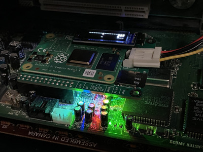

Mine arrived today, and (as expected with everything from Serdaco) it works perfectly.
Installed it on my Sound Blaster AWE32 and it's really great to have an internal solution for both GM/GS wavetable and MT-32/CM-32L!
I'm going to put the display and the buttons on an empty drive bay faceplate for control and the very important "insert buckazoid" messages and alike. 😀

Do you have a Unicorn in your Case or why is there a Rainbow 😁
Reply 148 of 424, by Salient
matze79 wrote on 2021-06-30, 20:27:
Haha. Yeah, I have the special rainbow-version of the McCake it seems. 😀 I kind of like it this way actually.

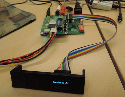

I bought 30cm long cables, I think i need to get longer
but anyway, making some progress on the 3.5 inch panel front

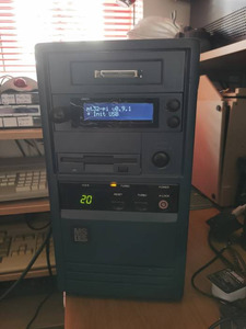

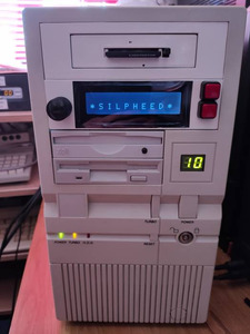

I went for the larger HD44780 based screens to fill a 5.25" bay:
29.76 KiB
1881 views
36.56 KiB
1881 views
The beige case (my 386DX/486DLC) was the first one I did, the blue one (my 286) is a slightly refined version that was a bit neater and has better button sizes, IMO.

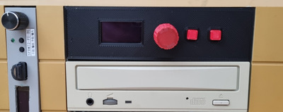

Unfortunately, I was too slow for the first batch 🙁 I have made a case anyway, I'm still iterating on it though...
Edit: updated picture...I'm not to keen on the red though and probably print it again with a different color 😉

You can use ferrite toroids in case you encounter noise issues. They often occur if cables get too long.
Winding a noise cable around a toroid can greatly reduce coat waves, for example. 😀
https://en.wikipedia.org/wiki/Toroidal_induct … nd_transformers
