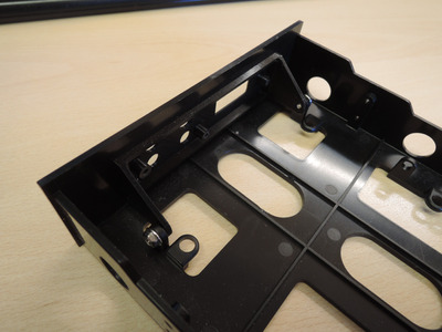

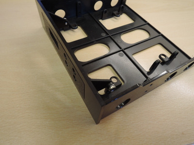

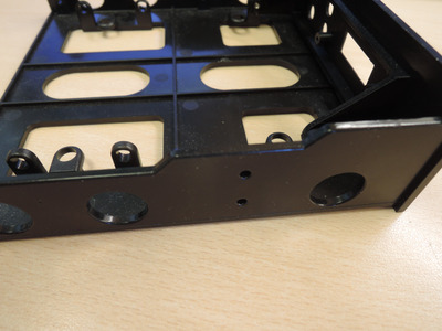

I need your help / feedback :
the current McCake front panel uses the front position floppy drive screwholes
these are well accessible in some cases, such as a 3.5" to 5.25" bracket i used for testing.
But apparently in many real life cases, the front position is not easily accessible or even not accessible.
Could you have a look at your pc and tell me if the front panel could be mounted this way or not ?
I may need to change the design to make it more universal

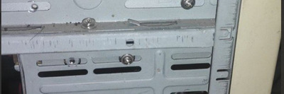

Here's my case, my chasis (Inwin C583) doesn't provide two screw holes corresponding front postion of floppy drive screw holes.
It has only one screw hole out there, No luck! and quite strange why they considered only one screw there. Anyway I need to something additonal to fix.
It'd be a good idea for the front panel to become more universal, including middle or/and rear position of floppy drive screw holes.

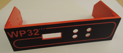

5.25" panel in development, this fits well on all my pc cases
color schemes :
- black + red for black pc cases ?
- cream white + grey or black for 'classic' cases ?

Nice! But but it would be better with button labels.
Yes, will add that 😀
Wondering if you might consider building the McCake + Pi unit right into the 3.5" bay mounting bracket as a complete assembly, allowing for modular front panels to match different case colors but also solving the problem of standard mounting as it could be sized to utilize standard 3.5" device mounting holes? It might be a whole lot cleaner in terms of layout since the molex power connector would be in the same area as the other floppy/hard disks in the computer, and instead of running the control/OLED header cable plus a power connector to the sound card, you just run a single ribbon cable to the wavetable header. This would alleviate the issue of clearance for the PI+McCake on smaller sound cards (usually the later ESS and Yamaha ISA examples) with oddball wavetable header orientations and avoid consuming an adjacent expansion slot in the computer.
