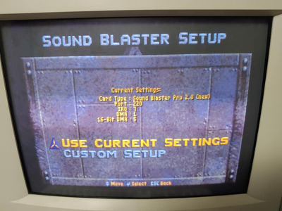

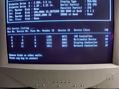

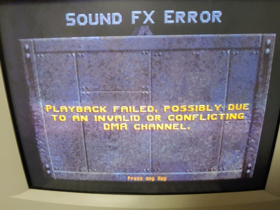

Any MS-DOS game that I launch from windows 95 does not detect my sound card in the sound setups for games BUT will play ADLIB from them just fine. I did notice during my boot sequence, that the IRQ for my multimedia device shows as "NA". Is there some sort of DOS driver i have to install when not in windows and in command prompt?

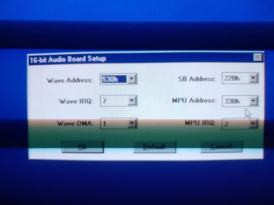

Please see photos below, The first photo is my current sound card configuration when it was installed..

That first screenshot does not show a high DMA, but the game screenshot has HDMA set to 5. I think your card's Sound Blaster compatibility in Windows DOS VM may be limited to 8-bit PCM. Does the game sound work if you set the game to a plain Sound Blaster, A220 I7 D1 without High DMA?

I got it working with the VY212 drivers above, Both in windows ms-dos and regular outside windows ms-dos! I guess it was just a missing or incorrect driver. All of the audio works perfect now! Thanks yall!
This MMSN824 card has an AZT2316A chip, which is 3rd gen Aztech (IMHO best chips/cards they made).
The Aztech gen 3 and 4 cards (and some gen 1 too) do support 16b 44kHz/48kHz stereo audio, but only via WMM. As with most other SB clones, in Creative terms they support max SBPro 2.0, so 8b 22kHz stereo or 44kHz mono. So if a game supports it, WMM will give you the best PCM quality, otherwise choose SBPro 2.0.
