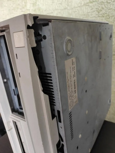

First post, by sam95

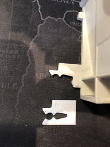

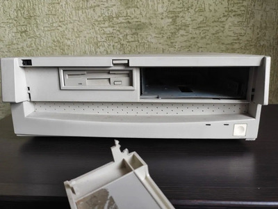

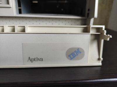

I just bought an Aptiva 2144 that took a tumble and part of the front console and the front panel hinges are broken. I want to restore it to its full glory. My plan is to model the broken sections, 3D print them, and fuse to the original part (also got some metal to unbend).
Front console seems straightforward, as it should be roughly symmetrical and I can copy the other side and mirror.
But the hinges, I've never seen them not-broken. So here's the ask: can anyone with a Desktop Aptiva (model 2144) take the front panel out (big ask) and upload some high res images with scale so I can model them?
I imagine this could end up being useful to more people, as I've seen more than a few 2144s with broken hinges.
Attached gory details of the busted boi I'm waiting in the mail.
Cheers!

Reply 2 of 13, by sam95
Here's what I came up with so far, right hinge (works pretty good),
944.46 KiB
1070 views
and left hinge, with gear.
938.47 KiB
1070 views
Left one is how I imagine it should look like, but haven't really got a clue. Still need to tweak the design to make the soft open really work.
Again, if someone has one of these and can share a picture, it would be much appreciated!

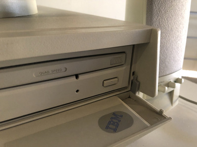

Reply 4 of 13, by sam95
Right-hand side looks pretty similar to my 2144's.
I'm attaching the STL files and SVG I created them from, if you want to give it a shot.
Reply 5 of 13, by sam95
Progress update, though I still have no idea how the original left hinge looks, I managed to draft one that works.
I'm attaching the latest source files in case they are useful to someone else.

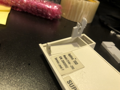

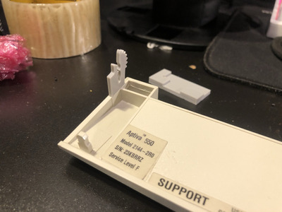

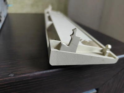

Reply 7 of 13, by sam95
Hey, I'm happy to learn that this might be useful for you.
I printed the parts with PLA and used Loctite super glue (the basic stuff, just the version that comes with a brush).
I realized I never uploaded pics of the end result, so here they are (you'll notice I was lazy to not properly color match the new pieces).
By the way, if you still have the part that got broken off, I'd be interested in seeing a picture of it -- it might help me improve the 3D model, having it be based on an actual part rather than something that merely works.

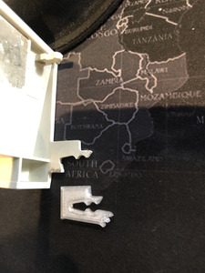

Reply 10 of 13, by alpm
brostenen wrote on 2022-01-02, 20:07:
alpm wrote on 2022-01-02, 19:59:
Hey sam95, sorry for the delay on updating this. Unfortunately I don't have the broken parts anymore. My mistake was to print th […]
sam95 wrote on 2021-05-10, 00:04:
Hey, I'm happy to learn that this might be useful for you. I printed the parts with PLA and used Loctite super glue (the basic s […]
Hey sam95, sorry for the delay on updating this. Unfortunately I don't have the broken parts anymore. My mistake was to print the part with ABS then, it just wouldn't glue itself and kept cracking with modelling ABS glue.
Will try to re-print with PLA!
Thanks,
A
Have you tried the superglue+bakingpowder aproach for gluing together? It is a trick from the plastic model kit world.
Test first on a piece of cardboard, when you start learning this. The second you add super glue to the powder, it becomes hard like concrete.
Hey sam95! I've tried that on my first attempt. However, the hinge got too large to fit (dremeled it down, but it broke). Then I tried ABS-specific glue from a local model shop. It didn't work great too as it was brittle and cracking. At the next attempt I grabbed some random piece of ABS, melted it together with the hinge and front-panel and added some ABS-glue on top. It's not pretty (see attached pictures) though and has some considerable amount of super-glue-baking-soda from my first attempt last year.

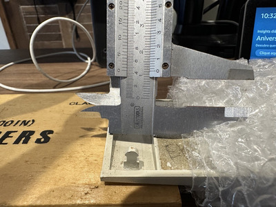

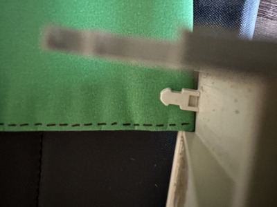

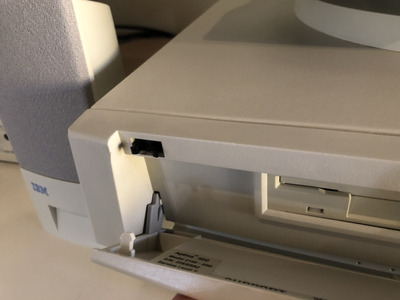

Reply 11 of 13, by caiot5
sam95 wrote on 2021-02-08, 17:15:
Progress update, though I still have no idea how the original left hinge looks, I managed to draft one that works. I'm attaching […]

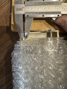

Thank you so much, that hinge works flawlessy!!!
But one of my Aptivas is missing also the little lock on the front panel that keeps the front panel locked to the rest of the case.
Did someone managed to create a stl of that as well? (I've attached an image of where it was supposed to be).

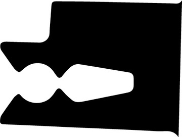

Reply 12 of 13, by sam95
I haven't and I can't do it right now, but here are some pictures that I took of one if you'd like to create one yourself.
Basically what I did was to take the profile of the part in photoshop and make it purely black/white (black part on white background), then import that profile in a 3D software (like TinkerCAD) and extrude it to the thickness.
The outer measures are in the attached pictures, but it's 2.5mm thick, 11.5 mm long and 6mm wide.
Give me a shout if you're stuck and I can try to help when I get the time.

Reply 13 of 13, by caiot5
sam95 wrote on 2023-11-20, 13:47:
I haven't and I can't do it right now, but here are some pictures that I took of one if you'd like to create one yourself. Basic […]
Thank you so much, I will check if a friend can help me with modelling, if he does and if he agrees on sharing the project, I will attach it here.
