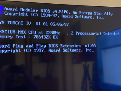

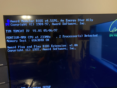

On the tyan tomcat this is the result With 6 128mb simms installed. The chipset and manual is only supposed to support 512mb.
655360 kilobytes
I have two more slots I can fill as soon as I figure out how to repair the bad slot
There may be stability issues for now I pulled out the other two sticks as I can’t save bios settings reliably until I get a replacement dallas clock. I suspect some timings need laxed. It hung a few times.

Reply 47 of 67, by Sphere478
chrismeyer6 wrote on 2021-02-02, 04:24:
Nice job getting that amount of ram working have you been able to boot an OS and be stable?
I got ME on it with 128 but haven't done anything else on it since 512+ I think more than 512 cmay be unstable I'm gonna experiment with it more once I can get all 8 slots populated
I'm gonna focus on my other build for a while and circle back to this
as a reminder this is on a tyan tomcat not the same motherboard as OP pics

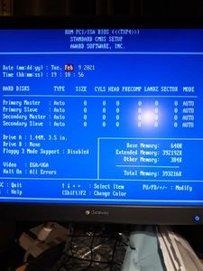

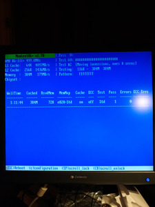

Reply 48 of 67, by Sphere478
okay, now back on topic for the p55xb2
I now have 2x 256mb mt16lsdt3264ag-13ee3 pc133 cl2 sticks and with both installed it boots but only counts 256mb I also now have 4 x 128mb 60ns edo simms I tried four of those and again only 256mb
I even tried two dimms and two simms in last two slots all simms and all dimms one dimm and four simms nothing I did gave me any more or less than 256mb
so something that repoman11 did is different than what I am doing and at this point I would like to know what ram sticks he got working in his motherboard so maybe I could try them?
Sphere's PCB projects.

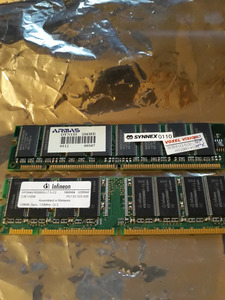

Reply 49 of 67, by Sphere478
Okay, I got a clue as to what may be going on here. It may be that you can only go 1.5x what mfg recommends which explains repoman11’s experience. Because I got 768 stable on the tyan tomcat by using all banks except the ones closest to pci slots with all four banks it fails post even on lax settings.
So I need to figure out what 128mb module to order.
Is there a module that is basically a single sided version of what I have?
    534.33 KiB
    1303 views
    1.47 MiB
    1306 views
Reply 50 of 67, by Sphere478
I got a 128mb stick that is the exact same as my 256 (same chips) but only one side and tried several combos including ones with it and 2x 128mb simms nothing worked to break 256mb
only combo I haven't tried are combos with 2x 64mb simms and 2x 128mb dimms
repoman11 if you could post details about the sticks you have that recognized as 384 and maybe upload your bios I many be able to try some more ideas I'm wondering if I just haven't tried the right thing or if my board is different I should be able to replicate your result even if it isn't stable like yours. 🙁
have you tried 128 dimm in bank 0 128 dimm in bank 1 and 2x64 in the last two simm slots ?

Reply 52 of 67, by Sphere478
Maybe you are experiencing some similar kind of ram error?
640.19 KiB
1254 views
What’s the arrangement of those chips? I see a sticker on line with samr chips that say 16x64
Mine are 16x8 right? (I’m still confused on how those numbers work.)
