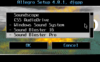

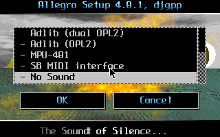

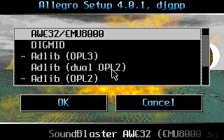

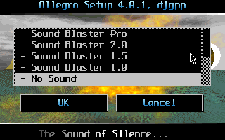

Cyberdyne wrote on 2021-02-09, 05:10:
Yeah. Many of us use SB PRO clones, so 8 bit sound is apreaciated. And someone should make a more detailed tutorial, how to get the data files. Still have not gotten Sonic CD data file.
Really ? 😳 Don't these SBPro 2 clones also have compatibility with Windows Sound System (WSS) ? 😕
I for example, used a PAS16 in the mid-90s and when Pentium II/III were around, many on-board soundchips showed SB16 settings mentioned in BIOS.
Using a SB Pro 2-only card still by the times Allegro library was under development must have been an odd scenario. Akin to playing games in CGA mode in 2000.
A plain SB Pro is so 1991 (~14 years before Allegro 4.2). It didn't even meet the requirements for MPC Level 2, hence alone Win95.
Edit: An older copy of Allegro that was part of SEAL2, has options for 8-Bit Sound Blasters. Hm. Curious! 😕
Edit: Hm. Or did you mean that the game should include 8-Bit samples ? Does Allegro library lack the ability to downsample ?
