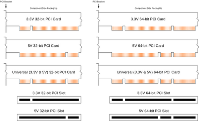

Reply 41 of 57, by luckybob
No, the tyan has 5v pci slots.
if the notch is in the BACK (rear) its 3.3v if it's in the FRONT, 5v.
the card I linked earlier: Re: Dual socket 7 build
is a universal pci card.

Reply 42 of 57, by Sphere478
luckybob wrote on 2021-02-26, 06:39:
No, the tyan has 5v pci slots. […]
I actually tested it with a tester card. it has 3.3v am I missing something?
I ordered one of the cards you linked to btw. will try it out thanks!

Reply 45 of 57, by Doornkaat
Sphere478 wrote on 2021-02-26, 06:57:
The notches determine which signalling voltage is used.
A PCI slot can be keyed for 5V signalling but still have 3.3Vcc present on the corresponting pins.
A PCI card keyed for 5V signalling can require 3.3Vcc to be present on the slot in order for it to work.
Only 66MHz PCI slots use 3.3V signalling.
Universal PCI cards are compatible with 3.3V as well as 5V signalling. They can be either 33MHz only or also be 66MHz capable. I don't think there are 66MHz only cards. The slowest card on the bus determines the bus speed.
Reply 46 of 57, by Sphere478
Okay so that’s like the I/O you are talking about but 5v cards still can get 3.3v I see. So those power cards you sometimes see are for boards that don’t have the 3.3v power pins on 5v slots?
