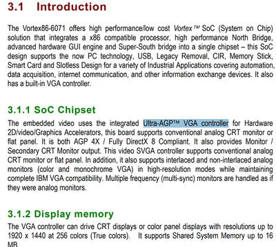

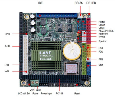

Reply 157 of 912, by shimart
I got Vortex86-6072.
I installed Win98se, but there is no video driver.
Can you advise me on the video driver of this board?
Who knows about Ultra-AGP™ VGA controller graphics cards?

Reply 159 of 912, by rasteri
shimart wrote on 2021-09-10, 07:25:
The OG Vortex86 was based on an SiS system-on-chip - perhaps one of these drivers ? - https://www.philscomputerlab.com/sis-chipset-drivers.html
