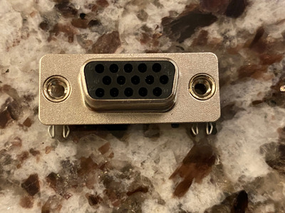

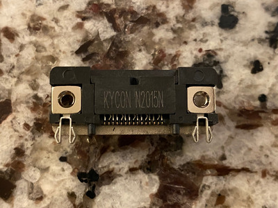

Is R10 supposed to be populated? It's listed as 'NP' but it has a description instead of "DO NOT POPULATE".
EDIT: Can you also verify the VGA connector? I've finished building everything and was ready to solder the VGA connector but the part number in the BOM seems wrong? (ugh!)
The BOM lists K202XHT-E15S-N and the BOM description also specifies a "high density" connector but these aren't through-hole and meant to be soldered on top of the board:

sofakng wrote on 2021-12-20, 21:51:
Only 2 pairs of pads aren't populated. R10 associated with the EEPROM and R19, part of the "pc speaker" signal.
your VGA connector doesn't look like it'll work here.
Here's what I used:
https://www.mouser.ca/ProductDetail/710-618015231121
and ofc, long lead time (sucks about the shortage of many components).
I'm not very good at navigating my way to viable alternatives and even less at editing board design to accomodate other connection strategies.
Ooops.... that was the BOM that I ordered so I have no idea how I got the wrong part... probably I just have lots of d-sub connectors lying around so I never noticed
Reply 218 of 912, by rasteri
Mu0n wrote on 2021-12-21, 05:38:
Here's what I used:
I think that's a low-density socket, intended for the Joystick connector. I can't actually find a high-density connector on mouser currently
EDIT : found one - https://www.mouser.ca/ProductDetail/EDAC/634- … xYZjEwpUA%3D%3D

rasteri wrote on 2021-12-21, 10:19:
Here's what I used:
OOPS was looking at the wrong line in my excel document, this is the one I used, it's slightly cheaper.
https://www.mouser.ca/ProductDetail/649-ICD15S13E4GX00LF
