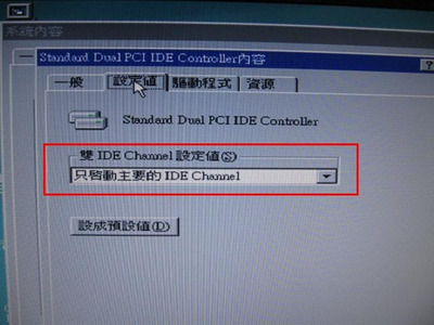

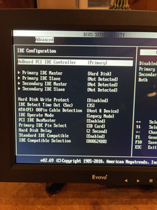

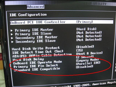

Reply 728 of 912, by Vridek
I also got an answer, but a little more specific than Duffman's. I'm just sorry we're sending duplicate queries.
Letter:
Thanks for your feedback.
The first question is about a system freeze issue in Win98SE: I looked for its document, and you might try to put "Enable" in "Standard IDE compatible" of the BIOS Advanced setting (attached picture: dx_bios_ide_configuration.jpg). Or you can try selecting "System Properties" in Win98SE; and changing the "Dual IDE Channel" in "Standard Dual PCI IDE Controller Content" to be “Primary IDE Channel” (attached pictures: win98_ide.jpg and win98_sys.JPG).
BIOS setup:
  • Power on and press “Del” key into the BIOS setup.
  • Go to “Advanced” and “IDE Configuration” selections.
  • Set “OnBoard IDE Operate Mode” to “Legacy, and “Standard IDE Compatible” to “Enabled”.
  • Press “F10” to save the changes and exit.
The VDX processor only supports SDHC card, with a storage capacity up to 32 GB with class 10. Please do not use SDXC on VDX board because it may have the problem during data communications.

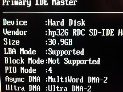

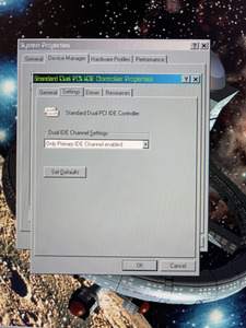

Reply 729 of 912, by divideBYzero

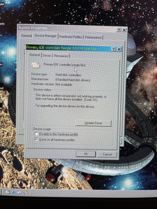

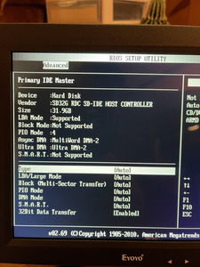

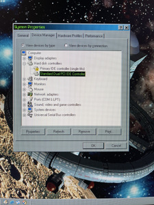

I have moved my Win98 install to from a 128GB card to a 32GB card using Symantec Ghost, the BIOS reports the card size correctly now, but the IDE controller still isn't behaving. I went into the registry to remove the NoIDE value, however that did not seem to help getting it out of compatibility mode. The only other noticeable difference from changing the BIOS settings and Windows settings as described is that just stopped the computer from BSODing when the NoIDE value was removed, unfortunately it didn't get it out of compatibility mode.

Reply 730 of 912, by Duffman
@divideBYzero
I've done the same on my WeeCee and can confirm identical behaviour on my end too.
Man for whatever 98SE just really hates this SD card slot!

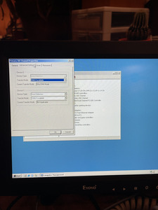

rasteri wrote on 2023-01-04, 20:57:
In my tests Windows 95 had the same slow transfer rate as 98.
Windows ME had a much faster rate.
It's worth a throwaway uSD card, as long as it plays Gabriel Knight III I'm good
1Bit Fever Dreams: https://www.youtube.com/channel/UC9YYXWX1SxBhh1YB-feIPPw
DOS Fever Dreams: https://www.youtube.com/channel/UCIUn0Dp6PM8DBTF-5g0nvcw

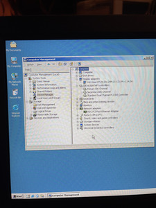

Reply 736 of 912, by divideBYzero
Tried Windows ME, no go. BSOD on boot about compatibility mode, identical behavior as 98SE. Minus the DOS goodness.
Tried Windows 2000, great luck! Works in Ultra DMA mode, got all drivers installed. Everything runs smooth as butter so far. Transfers about 70MB from a flash drive in 15 seconds for about 5MB/s with a super cheap MicroCenter 32GB microSD card. I need to test it with a better card now to see how it can really do. I think the MicroCenter card is the bottleneck now.
Power draw seems to be 80-100mA less with Win2k at idle. In addition, power draw goes up about 80mA higher than Win9x under load.

Reply 737 of 912, by divideBYzero
I went through the resource assignments of the hardware on both systems to compare. Of notable interest, Win2k does not assign an IRQ to the unused secondary IDE controller, whereas Win9x does. I will post a list of the data below if it of any use.
Resource Assignments
