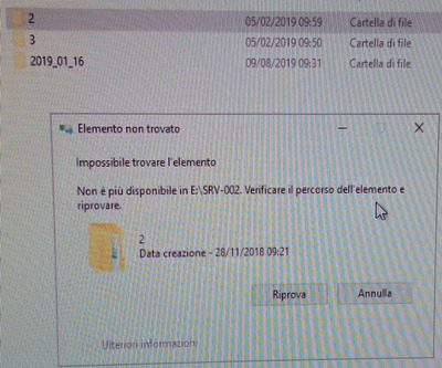

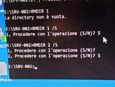

Yesterday on a windows 2016 server a file had a space at the end of the name, windows could not delete or rename it and could not delete the folder, DOS command "RMDIR [dir] / s" delete it.
Obviously a young technician lost 1 hour looking for a software that could delete or rename the file, I opened CMD and executed the command in 10 seconds

You do understand that RMDIR /s is a Windows command, available only at an NT5+ command prompt?
"Real DOS for real men" doesn't have it. That's why you had external programs like DELTREE. 🤣

rmdir is present in ms-dos since a long time ago, it's for deleting empty directories.
deltree is shipped with ms-dos, so not sure where you got "external" from?
