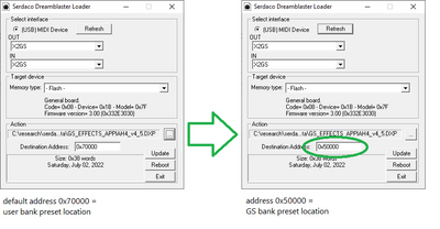

Also, anyone flashing this with X2Upload - Make SURE to upload it to address 0x5000 instead of the default 0x7000. The former applies to the GS soundbank and the latter default is for the user soundbank. @dreamblaster maybe X2GS needs a new uploader where you can select the target soundbank for the preset?
Enjoy folks.
P.S. I will later try this EQ preset with Buran as well, and record with it. But later 😀
Reply 227 of 307, by 1541
appiah4 wrote on 2022-07-02, 09:32:
Also, anyone flashing this with X2Upload - Make SURE to upload it to address 0x5000 instead of the default 0x7000. The former applies to the GS soundbank and the latter default is for the user soundbank. 😀

The preset for the GS bank is on a different flash location indeed : see the following overview :
14.26 KiB
2433 views
For upload to flash, there is only an upload utility for windows (X2Upload see https://serdaco.com/downloads/X2/?dir=X2_SoftwarePack), and only over USB.
The uploaded preset is persistent in flash, so you can temporarily connect the card to USB on a windows computer
to flash and test what you need. Afterwards you can place it back in the DOS / Linux pc and all settings / banks are
are retained as this is stored in flash. The preset is applied after each power cycle or soft reset.

This is the trick i've been looking for since my post on 2021-12-23. Gotta flash the presets to 0x50000 to get them to stick
