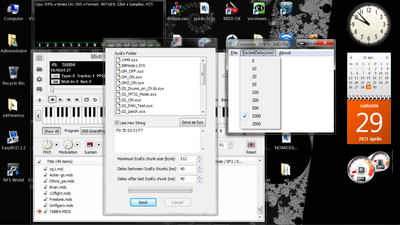

Reply 5 of 7, by Falcosoft
Hi,
1. You said you used FSMP for playback. In the right click context menu of the playlist you can find 'Pause between Songs' and you can set 0,1,2,3 sec. pause so setting delay in the Midi file itself is not so necessary. I think 2 sec. delay between Midi files is ideal regardless of soundfont switching and most likely it's also enough for reasonable sized soundfonts to load.
2. With the help of FSMP + SYXtoMID you can speed up the creation process of your Midi files with included SyeEx.
Use right click context menu of 'Reset' button ->Select /Send Custom SysEx. Here you should check 'Use Hex String' and type the required SysEx message. In your case e.g: F0 7D 02 01 F7 to change soundfont to 1. Then press 'Save as Syx'. Finally open the saved Syx in SYXtoMID.exe and set your desired delay in 'Packet Delay(ms)'.
